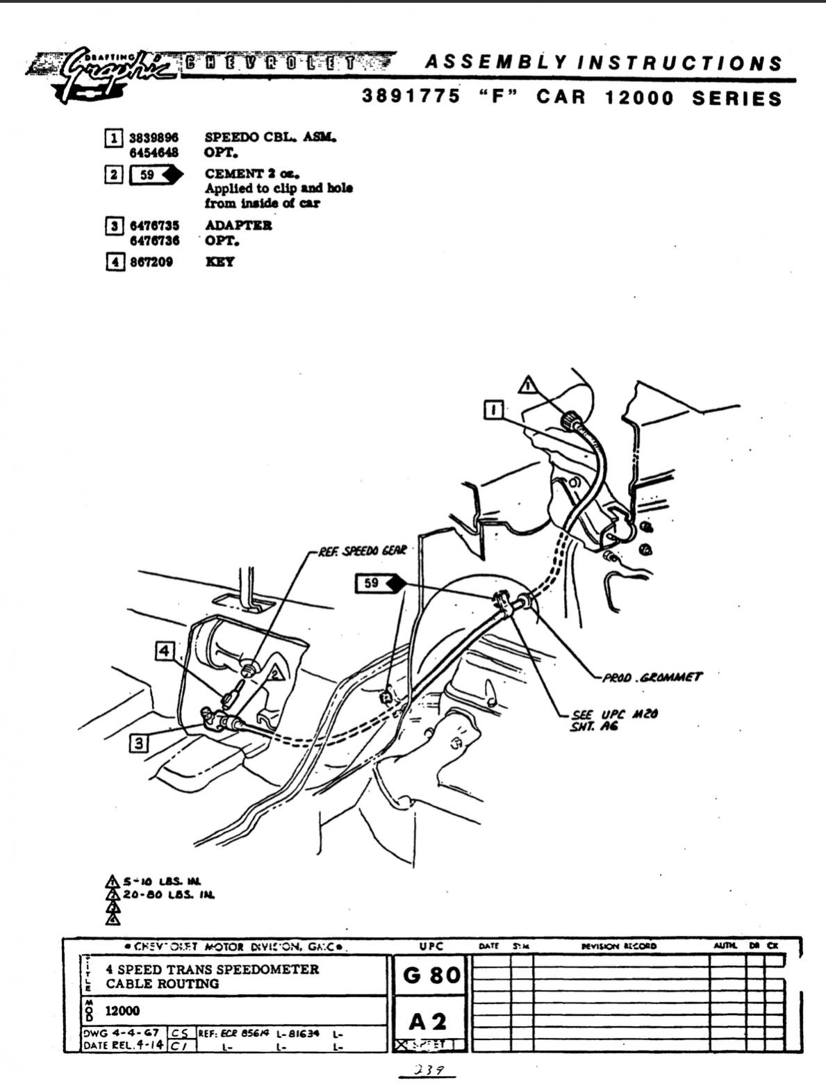

Jeff for reference there is an unrestored example with a 6476736 .777 adapter. The variable is the all important drive gear. My car is also equipped with 456 and when purchased did not have an adapter and the speedometer reading is accurate. In a few months I will have access and will know what driven gear is in the original transmission.
