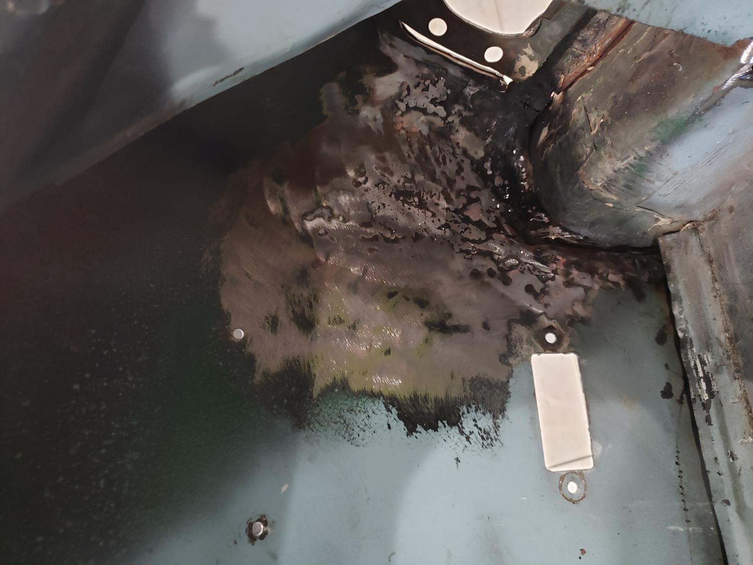

Here are some pics of the inside of the quarter as well . Getting closer after some metal work to the proper shape using a profile gauge.

Trunk view before metal work
Metal shape getting close..
