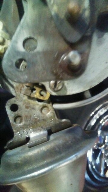

Originally Posted by X66 714 View Post
What cam goes with the 1112000 ? On a quick look in the search section, I've seen 724, 728, & 732. Mine has a 730. It's a 0C18. A little help please. Thank you, Joe
Just curios Joe, does your dist. have the original vacuam advance still attached to it if so are the stampings ms 355 15. thanks Marc.

Default distributor vacuam advance #
Joe while at the other property i took a picture of the vacuam advance if needed for future refrence.
