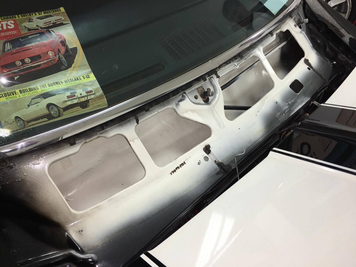

Paul,
The cars restored with the body color on the front of the firewall and over the tag never look quite right to me (personal opinion). Yes, there are some examples of cars where that happened but usually it is fogged on when GM did it and when redone it always seems to have more thorough coverage. The typical Norwood '67 Z had the stripe color contained under the cowl panel, sometimes crisply masked off under there and in other cases it is sprayed there without being masked. The ones which were not crisply masked under the cowl panel did sometimes have stripe color which extended more toward the front of the cowl. Below are some '67 Z Norwood examples. The typical LOS '67 Z, which yours is not, had the majority of the top of the cowl painted with a distinct masked line at the leading edge, but I have seen one example prior to restoration where it was crisply masked off under the cowl panel.

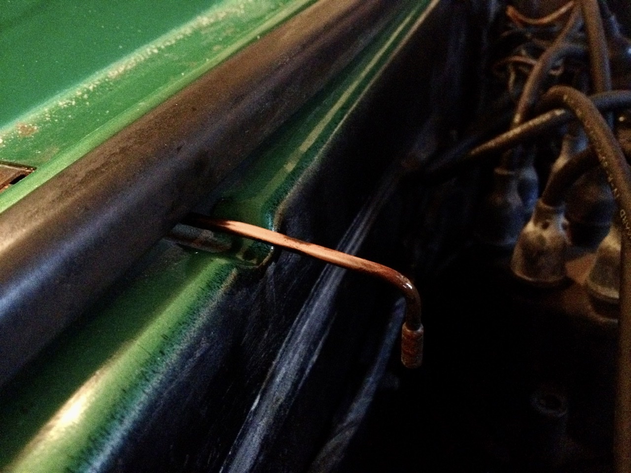

May not apply to your 67 but my 69Z is a 12D Norwood car and it doesn't appear to have been masked at the firewall. It's a black stripe car and it's clearly visible that they sprayed the gloss black under the cowl and just extended it all the way out the top of the firewall. Then a duller black transition can be seen on the forward facing firewall. My firewall blackout wasn't applied all that great either as there are areas of Frost Green showing through around the trans tunnel area and under the booster.
But that's 2 years later than what you're looking for.

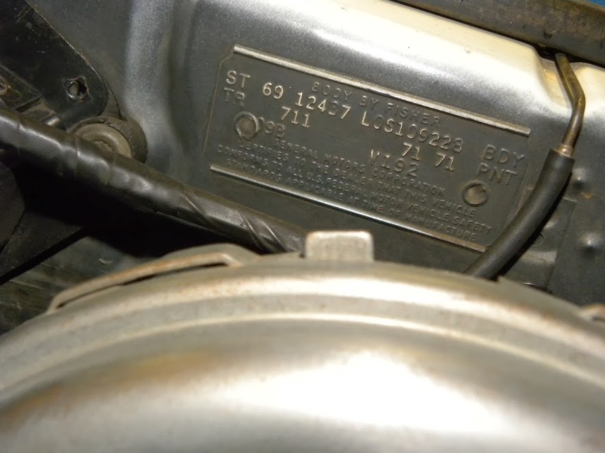

Firewall on 09B LA built 69
Because LA was multiline they used color code numbers whereas Norwood used names... 71 71 on this firewall norwood would typically have L BLUE
