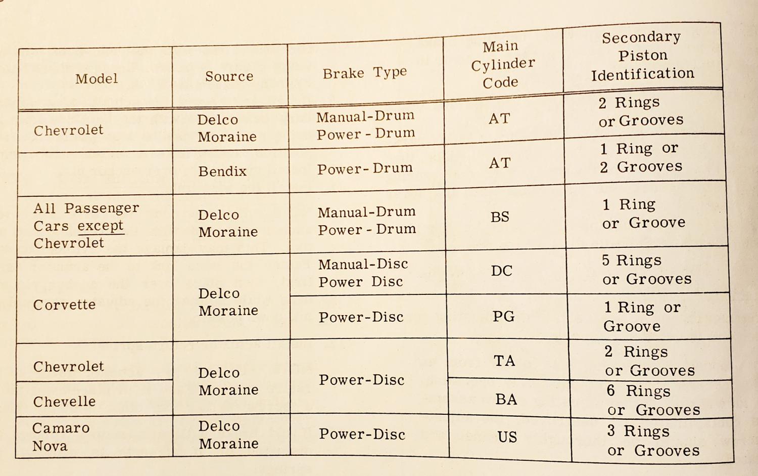

From what ive been told and read your car should have a 5468309 and I have a master from a Nova with a US stamp and have been told the Nova and Camaro share the same masters and codes. There is always an exception but thats what I have.

The 69 Nova disc mc is stamped US.

Default Master Codes
Here is a pic from the 1969 Chassis Service Manual.
