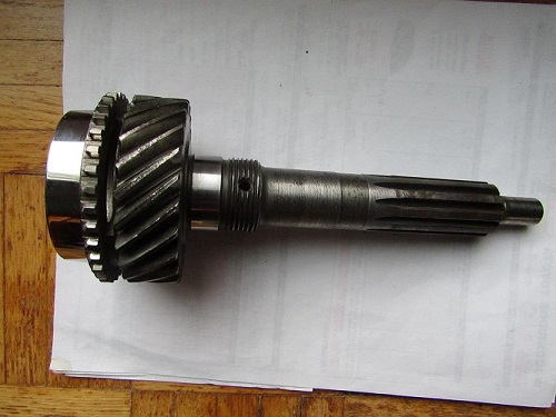

Ralph,1 ring on the input shift is close 2.20 ratio. 2 rings is wide 2.56 ratio. No rings is m22 on the Muncie factory input shafts.

I have a 64 input shaft with 24 teeth with no rings (wide ratio) , the tag that was removed from same tranny that reads 3841435 if i remember correctly was a 3.36 rear ratio. Maybe some one can confirm .
Early Muncies don't follow the same rules as later ones do. I also had a wide ratio 2.56 (325 case) with no grooves on the input.

Looks like 63 through 65 had no groove on the m20 and 1 groove on the m21. I did not know that.
