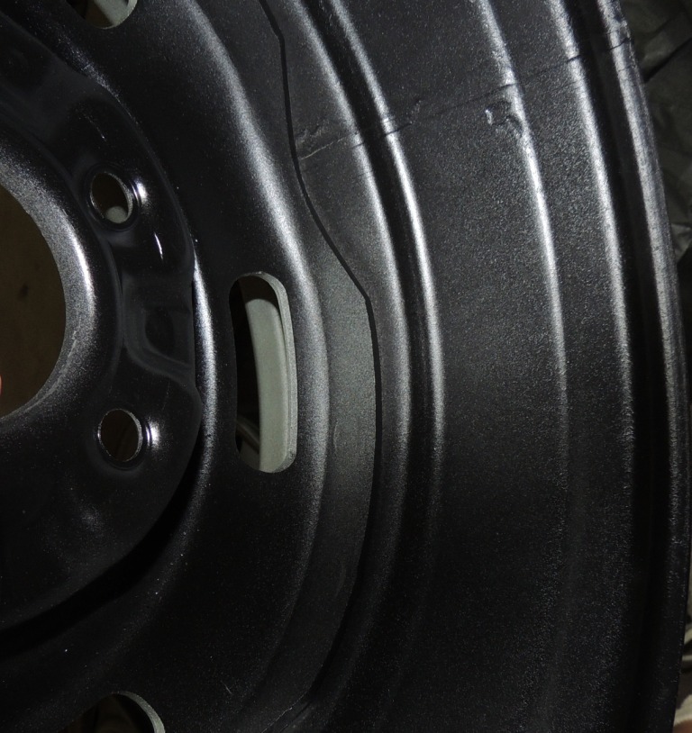

I like the old Survivor look better.
Last photo is my Original spare in my ‘66. The backside is definitely a gloss black with a slight silver coming through the slots upon close inspection.
