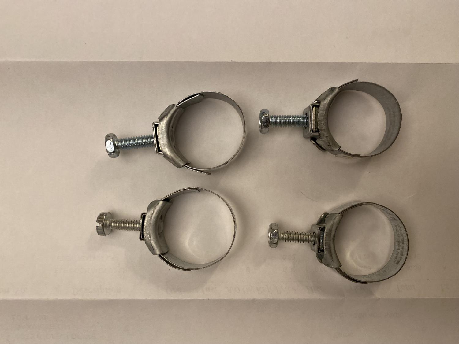

I have found that the repop clamps just don’t allow enough clamping before they fail. I have had luck with using a clamptite safety wire clamp first and sliding the tower clamp over the top and winching up enough to hide wire. No worries about the clamp failing..
