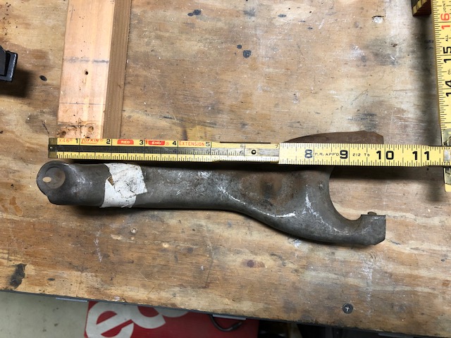

I am having some trouble with my new clutch install. My install is an Muncie M21, '621' bellhousing and 11" clutch behind a 350 sbc. The fork I have for this is the ( 10.4 "in length). when installed it will not center the throwout bearing on the clutch diaphram fingers. After researching this problem I was advised that Chevy used two forks in '69 based on the clutch size/bellhousing used. Theey are: # 3892632 and # 14066235; Per the information I received, clutch fork # 14066235 (which measures 11" in length} was used with the '621' bellhousing and 11" clutch when installed on the higher horsepower 350s Camaros { like a 350/300 hp in an SS}. The # 3892632 fork was installed on other sbcs and ironically the 1969 Z28 as well. If anyone has can shed some clarity on this subject it would be much appreciated. Regards

Hmm, it doesn't sound like the 14066235 (73-81) fork will work without modification based on this post: https://www.camaros.net/threads/clut...rewall.200119/
I went down and looked at my 621 bellhousing and fork destined for my 69 SS350 and measured the fork (no numbers on it ) and it measures 10 1/8". When looking down the center it does look aligned, but I hope it is the correct one! I bought it many decades ago!

Thanks, did you fully seat the fork on the ball stud for this picture?
Yes it is.

3892632 is the clutch fork for both 11" and 10.25" clutches
All the GM parts books verify this. There are not 2 different forks.
Both bellhousings, the 403 and 621 took the same fork.

Thanks for the clarity fellows. Per your post and the pictures above I re-checked mine and it fits just as in the posted pics. I simply had it seated too deeply in the fork opening, not riding on the end of the fingers. My learning experience. Regards
