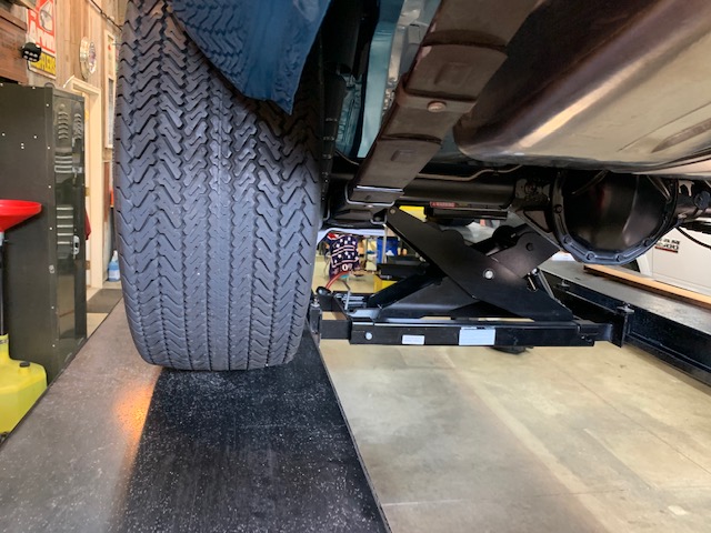

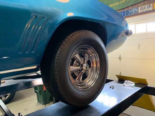

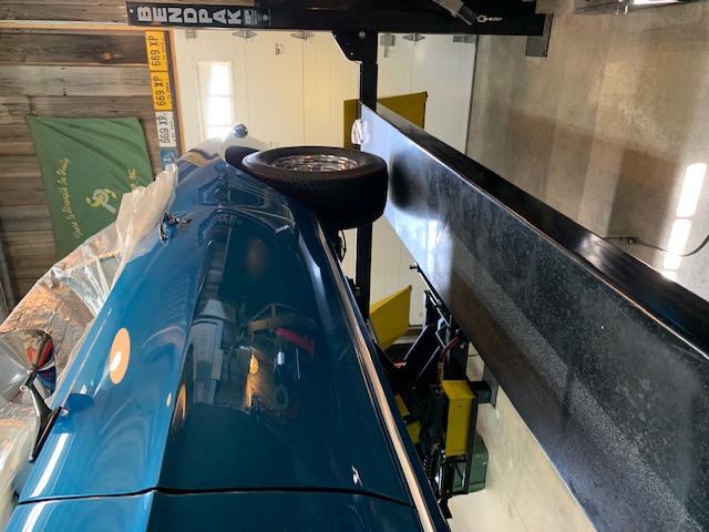

Also bolted on my 15 x 8 Cragars to verify clearances before sourcing aluminum slots and slicks for the Rat's Nest theme. These Cragars have a 4" backspace and the Pro Tracs are 9.25" tread with a 10.5" section and 27.75" diameter. With the car weight on the tire, the top of the tire is just below the wheel opening. I'm thinking I need a 15 x 10 wheel with a 3.5" to 4.0" backspace with a 10" wide slick. Anyone have a wheel/tire combo like that that can show me how it looks mounted on the car?

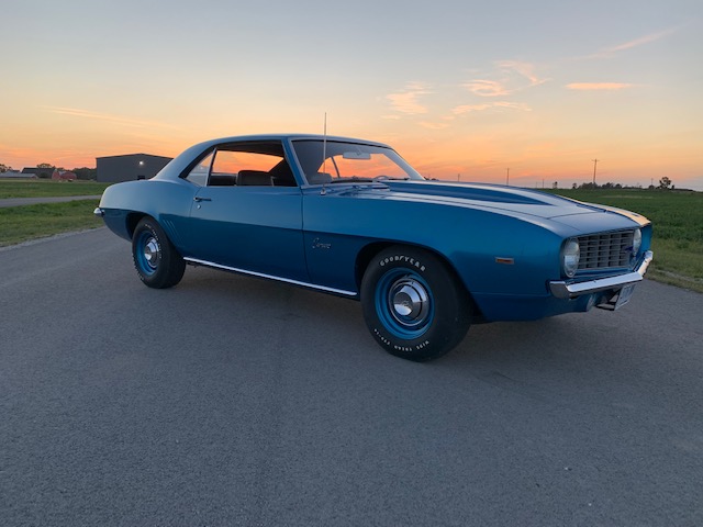

Default Pre-Rat's Nest photo shoot
Took the car out for a photo shoot with a professional photographer (not me). I wanted to get some high quality photos of the car in its as built configuration before I do the Rat's Nest conversion (October) for the MCACN show and probably for the rest of my ownership. These few are just from my cell phone, the couple of previews of his shots look pretty incredible compared to these, but thought I would share a few. Enjoy!

Very nice, Jim!
