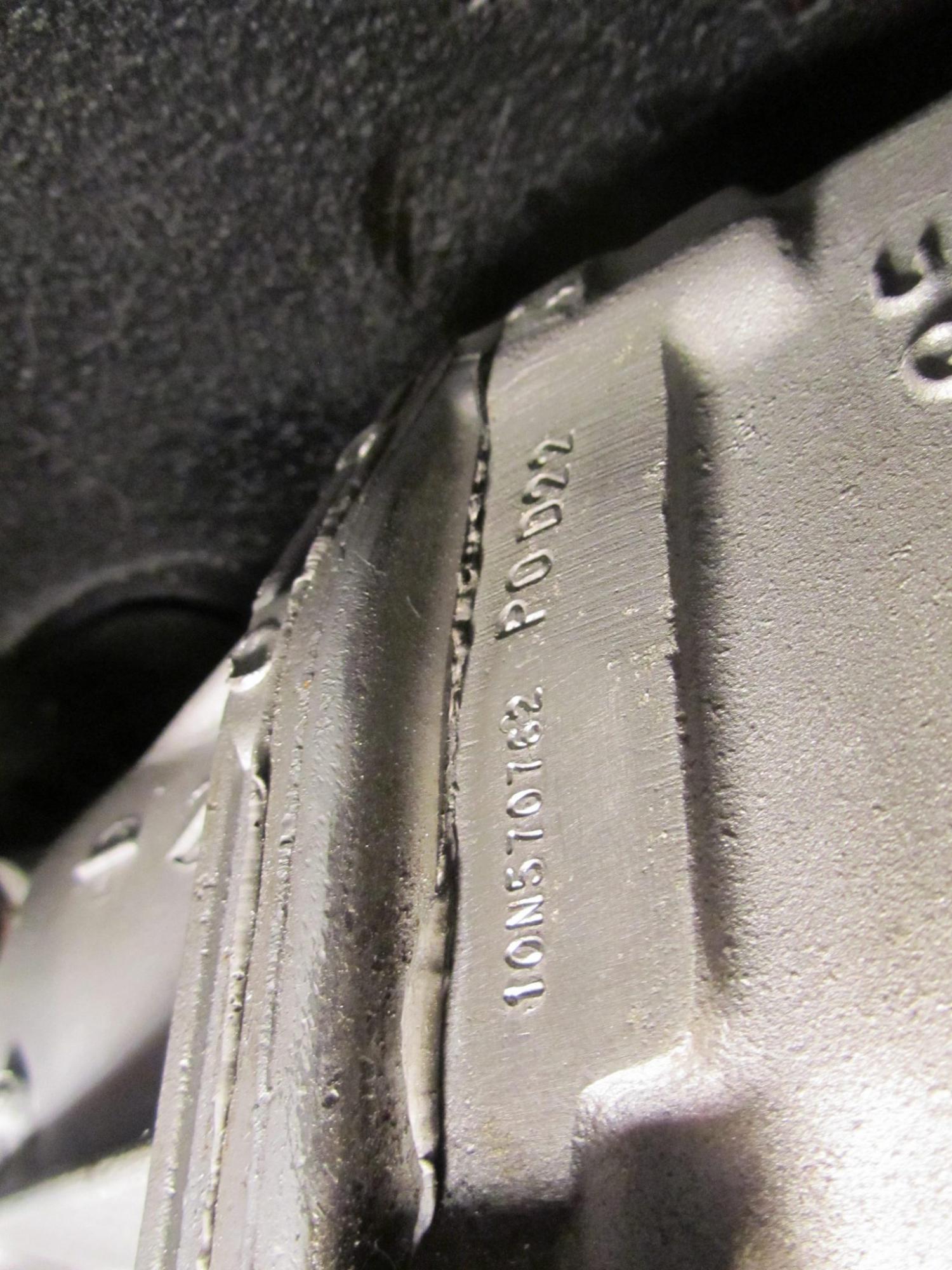

This oughta be one to watch....same owner since 1971, 11K miles. Has been repainted and some other fluffing, but owner seems like he has been incredibly attentive (perhaps too attentive???) in maintaining this car. He's only put on 1200 miles in his 50+ years of ownership.

Pictures in shade, first alarm. You can still see the color difference from the doors back. Owned the car for 50 years, I'm pretty sure the knowledgable owner knows the car came with 711 standard interior (can tell a mile away those seats have been redone). 11k miles, what bs. Whole car has been redone.

Too attentive is right w/ sanded TT also engine stampings look dental picked?
Eyeballs inspection best but info/pics/multi alterations suggest mileage claim may be suspect?
124870N570762

Norwood didn't stamp the VIN on the pad in '70.

So is it a restamp? And vin was added?

I questioned the vin on the pad also. And didnt all 70 Z's have the 8 grand tach?
I wondered what those hood stripes look like in person, either scratched up or just dirt smeared. And those seats wow
