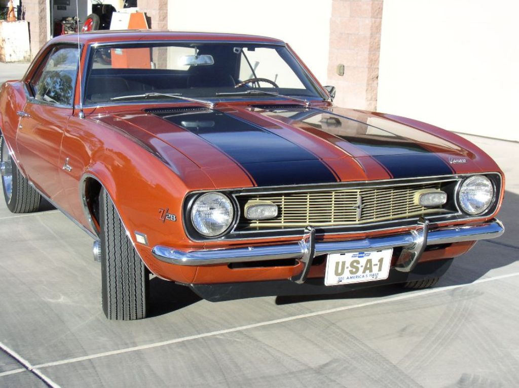

ok so I bought a unrestored survivor if I pull the engine to replace the timing chain is it still considered a true survivor the nylon timing components scare the hell out off me

its a 68 z 57000 miles I will post pictures of the gear when I get it out, was not going to not pull the engine but I think that is the best way to do it

Is that Corvette bronze?...Joe

yes no rs but kind of a high optioned Z
