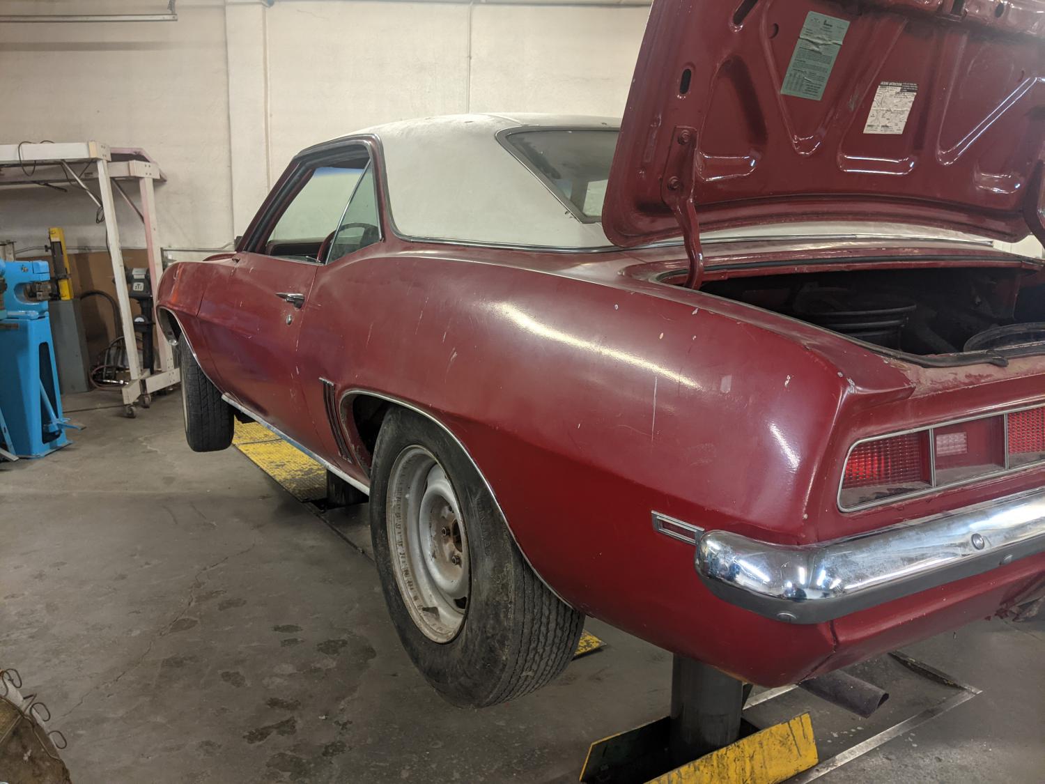

A few pics.

A few progress pics

So was the pinion yoke on this car painted black or natural steel originally?
Are there any stripes still visible on the driveshaft?

yoke was raw cast iron. driveshaft bare with orange, brown/tan, and purple/blue stripes from front to back and the u joints lined up with each other.
