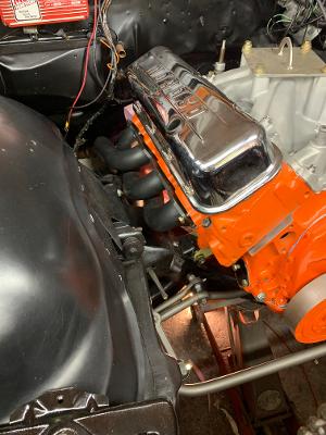

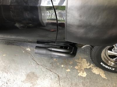

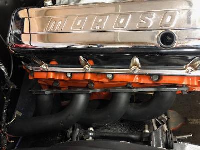

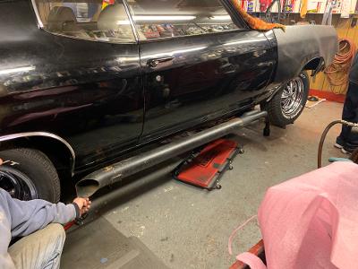

Congrats on getting one side in. Worst case, you can unbolt the motor, raise it up with an engine crane and fit the header in loose and then put everything else back in place. A bit like fitting a jigsaw puzzle together and certainly a 2-3 person job. A pain in the a** for sure, but that's worked for me in the past when I did not have access to a lift.
