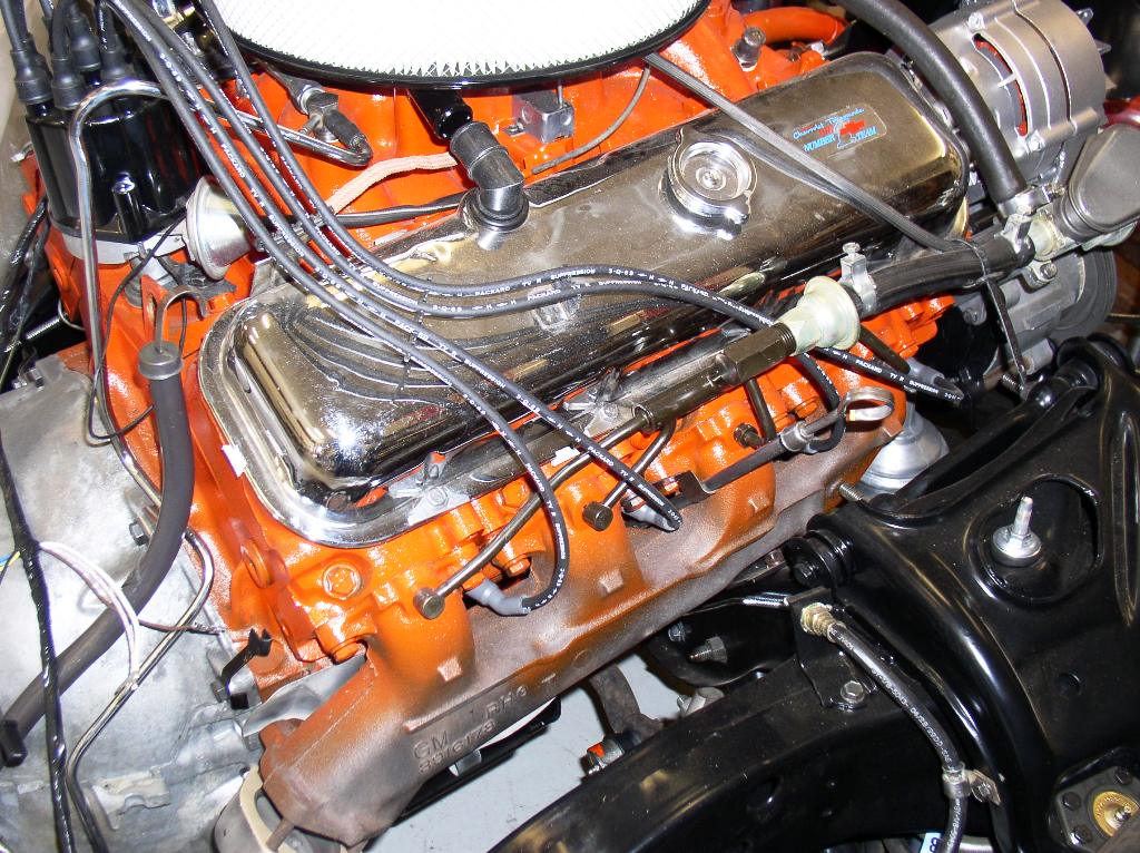

My late 1969 Camaro has that valve cover...always has. Engine number is T0821CJG....Joe

RH cover has no clips...Joe
