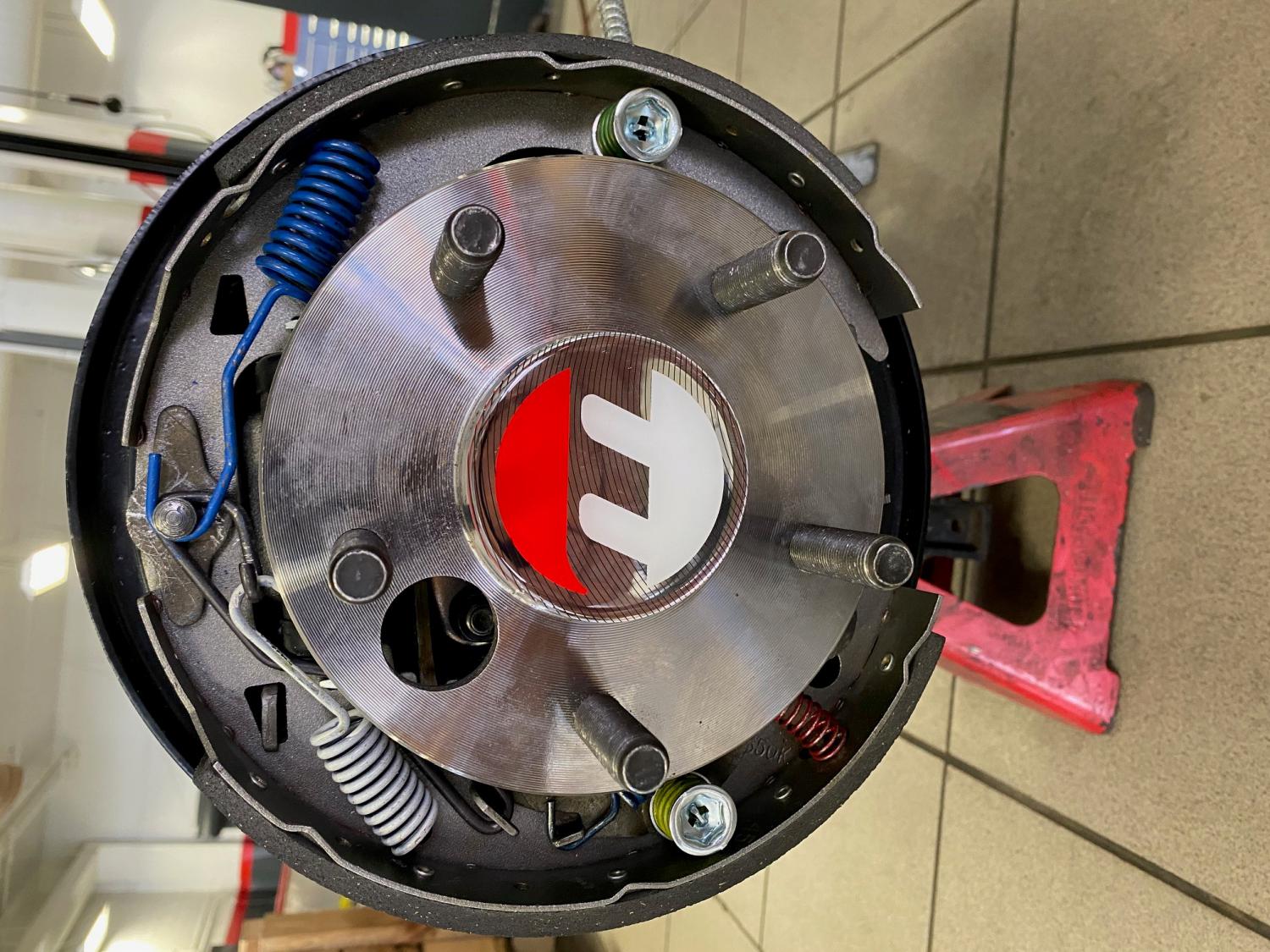

I had a couple hiccups. As previously mentioned, I bought my rear end from Moser back in December. Went to install the axles and noticed we had to machine the backing plate to fit the larger 35 spline axles, no problem my father in law has a lathe and made quick work of them. Then I went to install the axles and found them to very very tight, well actually they were bottoming out against the Wavetrac. I called Moser and they accessed the blue prints to my build... pretty neat they save those files. The guy on the phone determined the bearing retainers were pressed 1/4" off of what the plans call for causing the axles to bottom out. No problem, I sent them both axles and they corrected the issue and installed new bearings.

I was a Moser dealer for 15 years. I know exactly what you are talking about with those spring perches. There are better quality perches, but when you buy the rear end from Moser you don't get a choice. Tom's Differentials sells a much better perch if you ever need a set for something else. The hole in the backing plate needs to be bored to 3.155 inches so that the bearing can pass through it.
