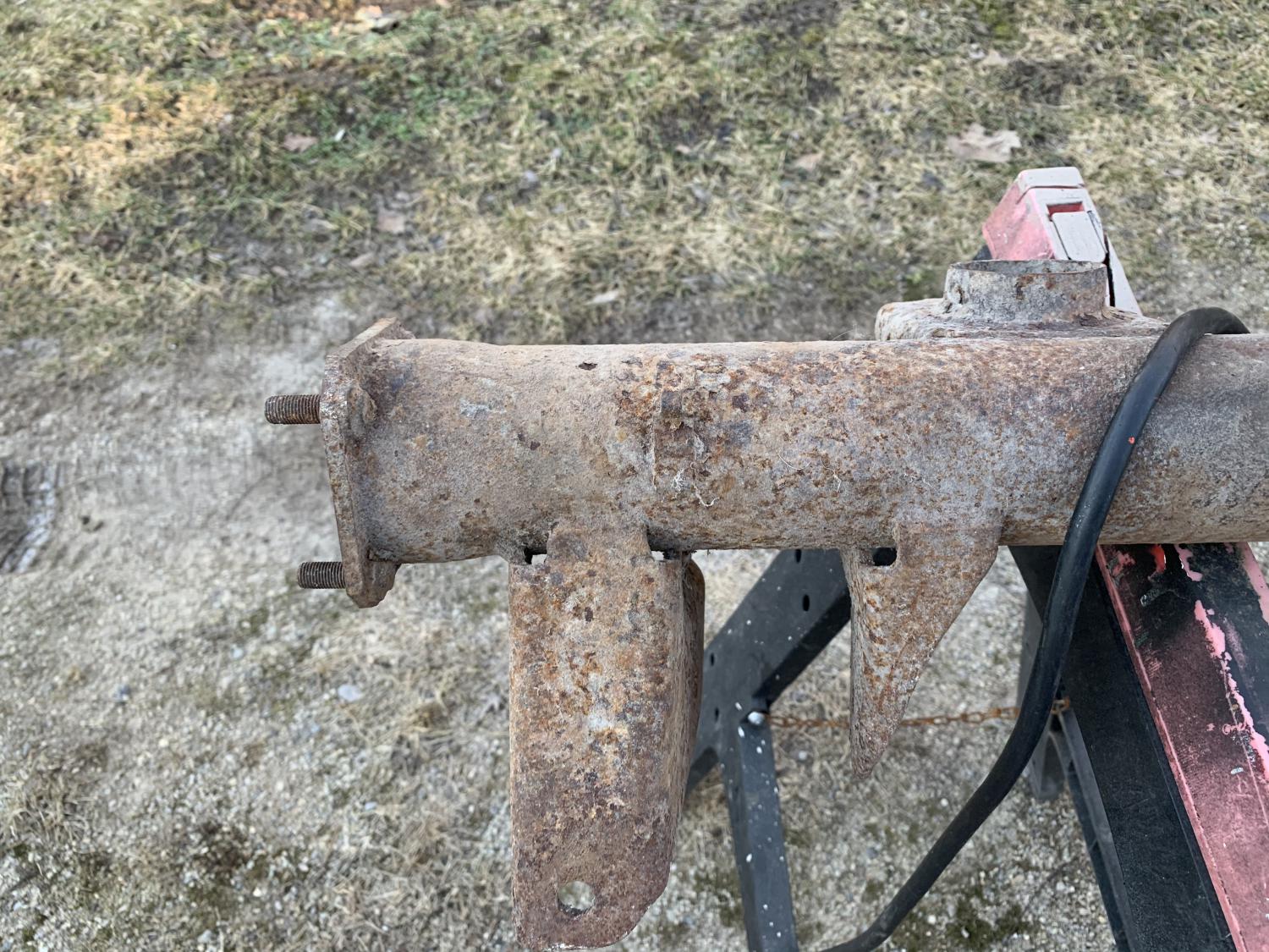

Started cutting the perches off today.
The welds are tough to get to, but free is worth a lot of tough!!!

These perches are difficult to cut off without damaging them, but I did it.
Now I need to dress them up, sandblast, and primer.
Now I know why I never hear about GM A-Body rear end perches getting ripped off at the drag strip. (Solid!!!)
One step closer to 13.999

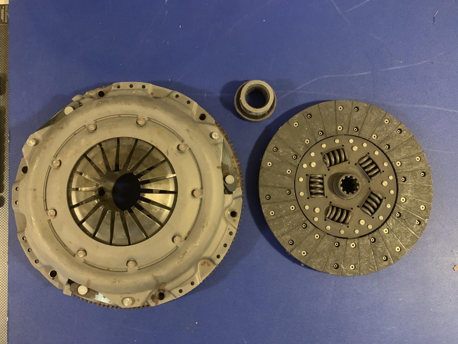

Thanks to Albert Galdi I have a new clutch to abuse.
11” 10 spline GM replacement
Now if it will warm up, I’ll get at it!!
