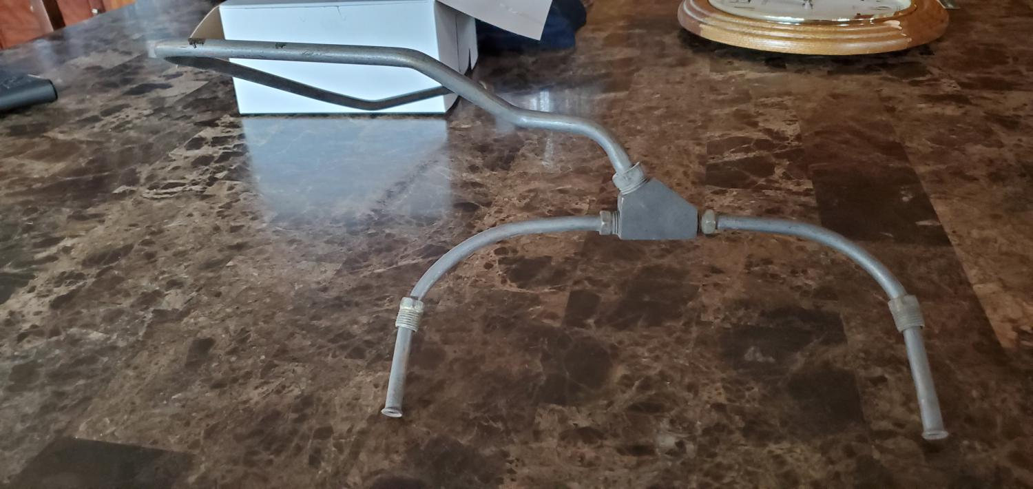

I dug out the fuel line I picked up years ago. thoughts?

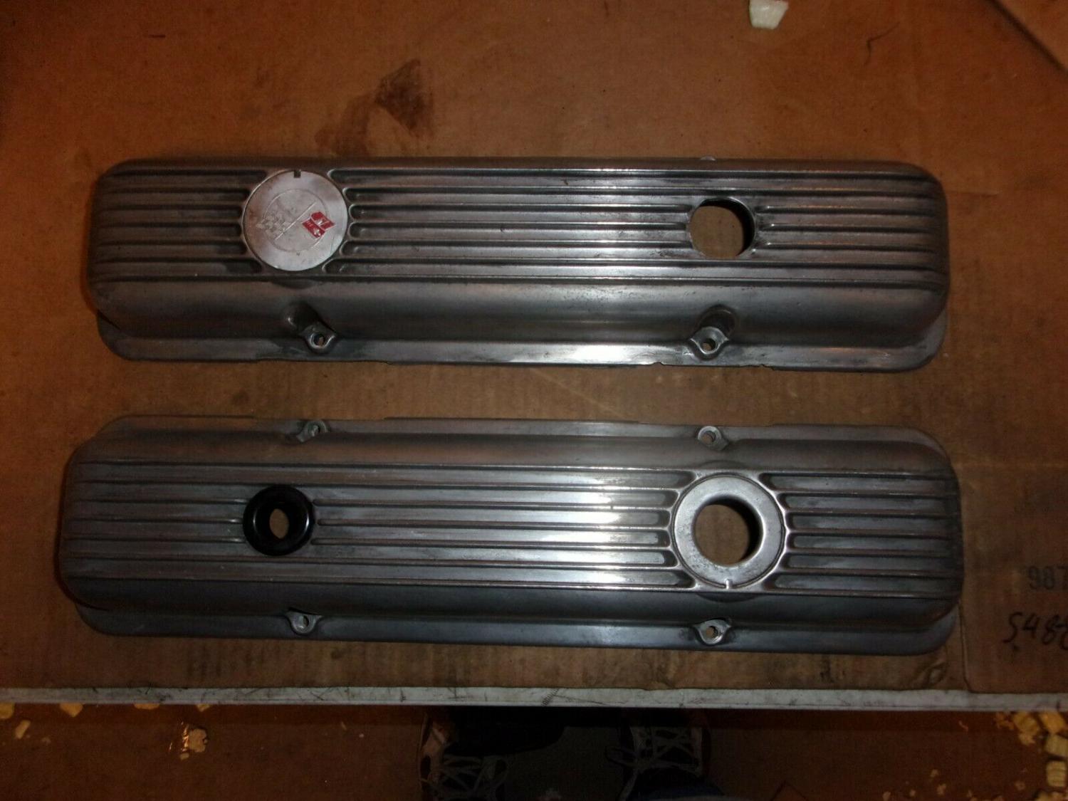

I was (what I'd call) lucky enough to pick up this pair of valve covers on ebay last week for $80. At the time of the resoration new valve covers where purchased and installed, but with the twist oil filler. Very happy I found these.

Nice score on the valve covers... they are not the easiest pieces to locate being only a 2 year usage.

Hi... The valve covers are good, the fuel block good. Remember what I said, you NEED the correct distributor shaft and top cam to complete the deal.
