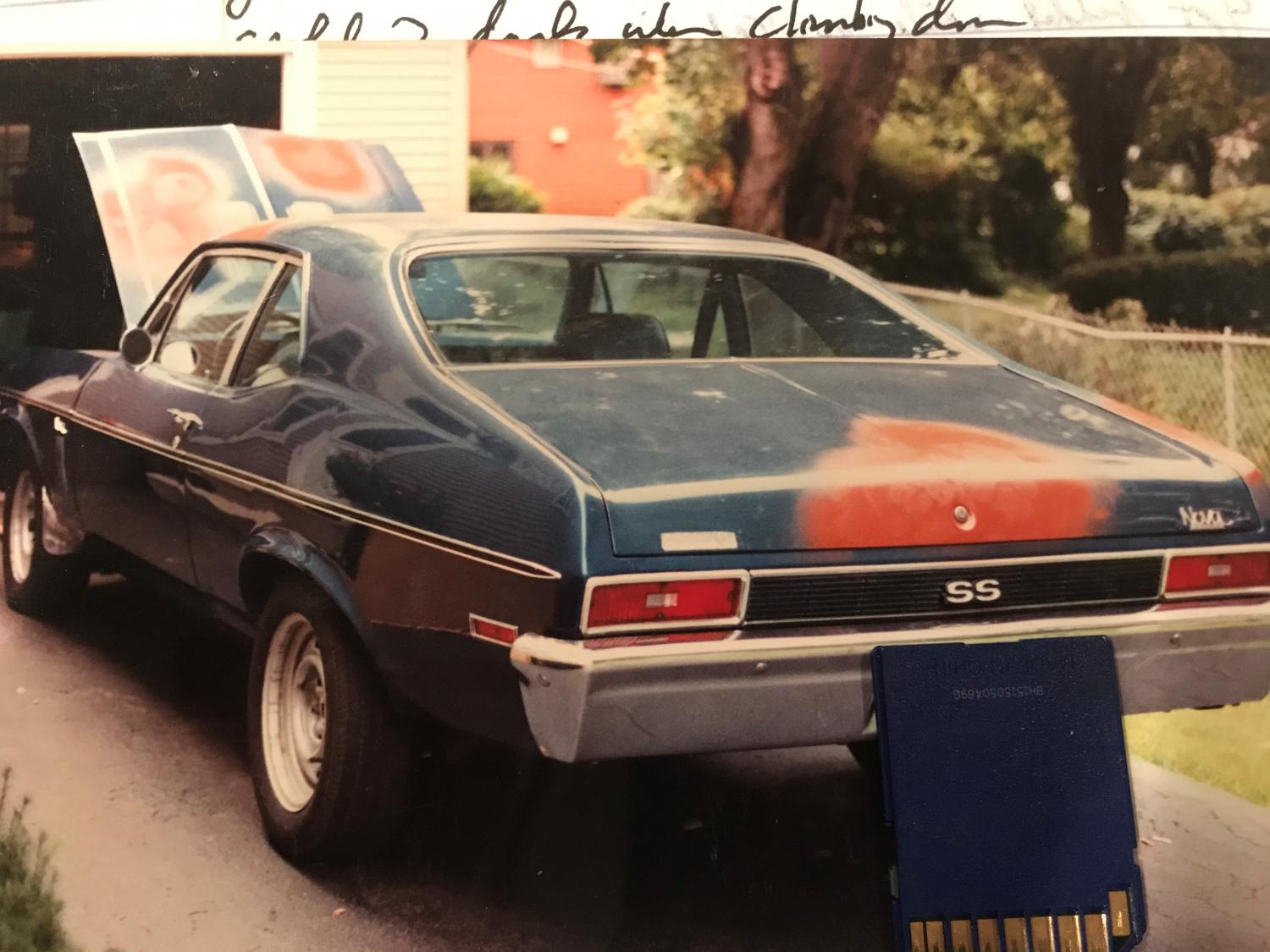

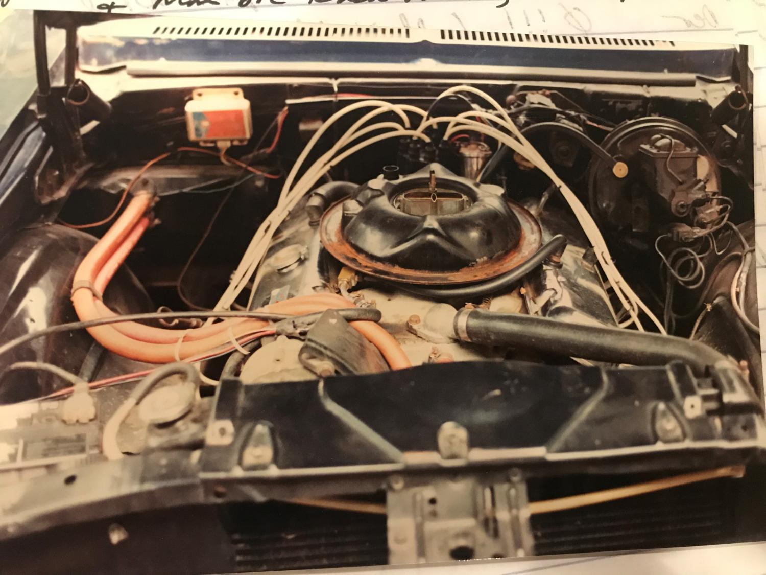

Fast forward to two weeks ago. I have stayed in touch with the prior owner and he called me and told me he had found several pics of the car from 1988 before it was refurbished by prior owner as well as an album of pics during resto. To say my son and I were excited to pic these up was an understatement. Interestingly, pics seem to reveal a single 3/8 fuel line, L78 core support, etc. I would like to see what people much more knowledgable about these cars think. Financially, I could care less--I have no plans to sell the car and when I am old it will go to my son. It is simply for historical purposes.
Do you think this was originally an L78? Any other clues you are seeing in pics?

Engine bay photo shows the low profile intake and other BB features...

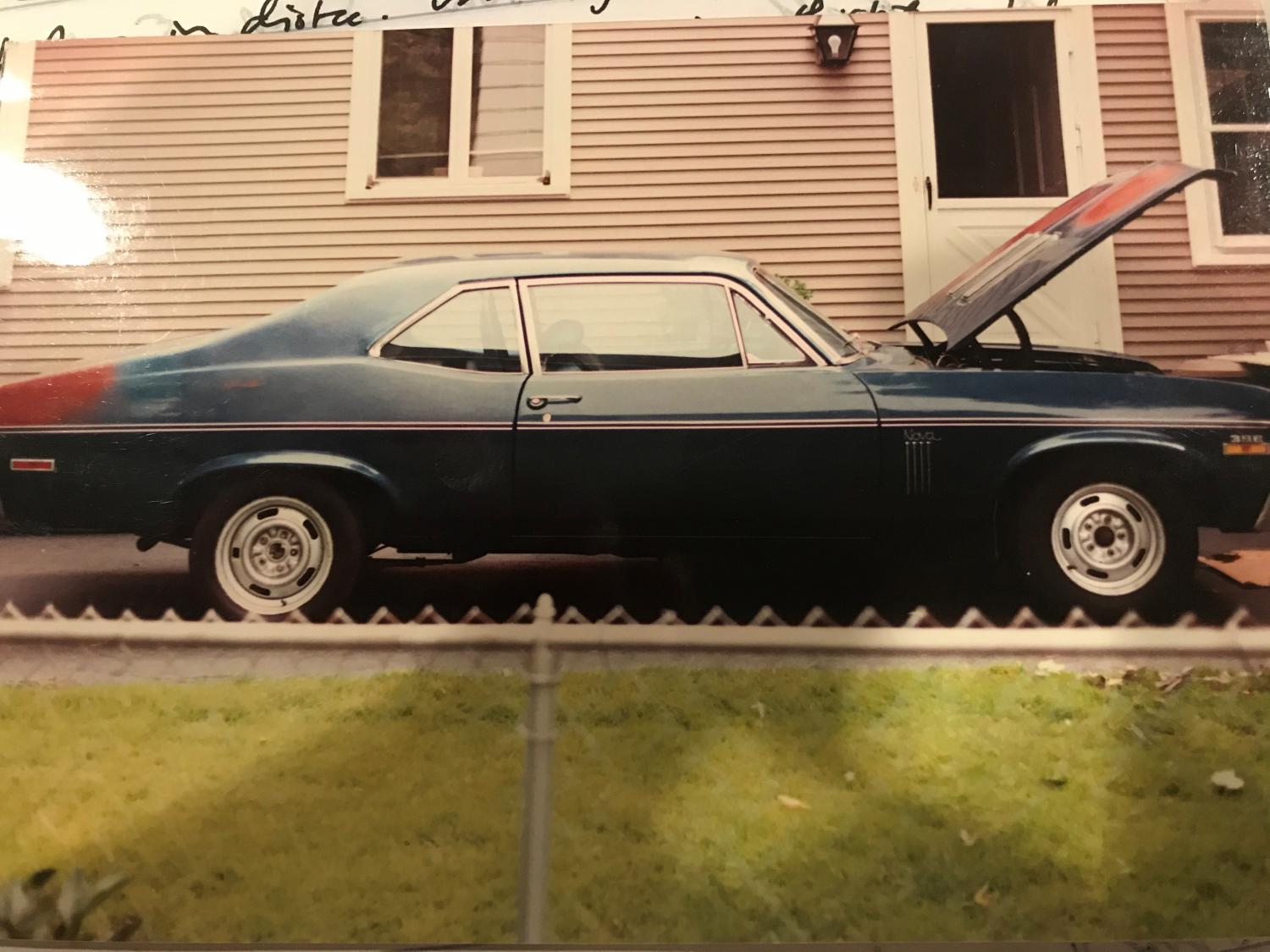

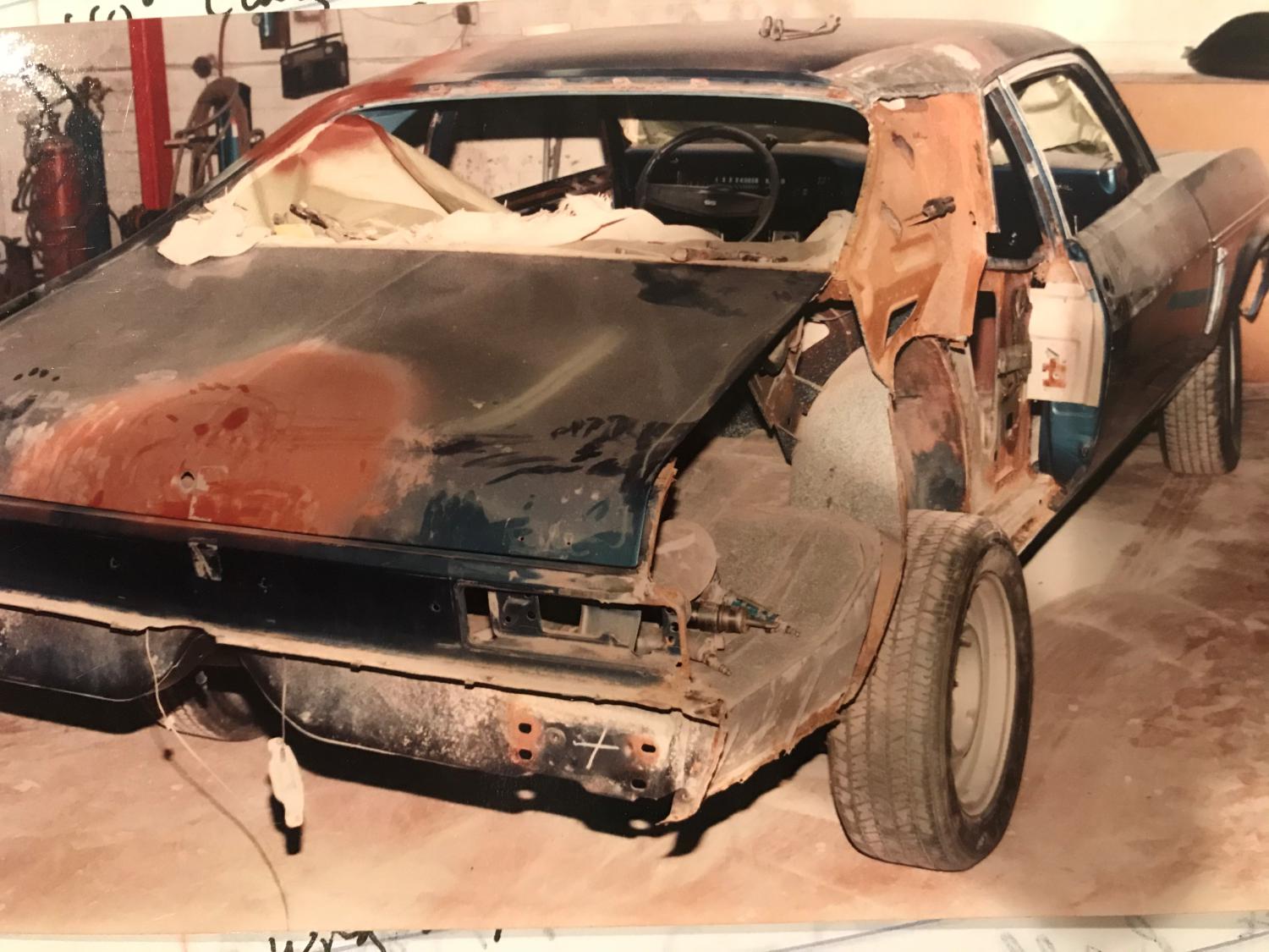

I have uploaded several more pics. The first 3 are of the car prior to restoration in 1988-1989. It appears to have been a pretty solid car, certainly not from NY most likely. Price for car was $5000--1970 Nova L78 52,000 miles is noted on back of pic. From the before pics, it does not seem like full quarters needed to be done. However, the owner at the time did not appear to want any patch panels and thus quarters were replaced as well as wheel houses with NOS GM at the time sometime in the 1990-92 timeframe--on back of the pics he states " no shortcuts, any panel with rust was replaced with full replacement panel from Chevy dealer" He tabulates on back of final pic that he so far had spent over $20,000 at the time in paint, bodywork, mechanicals etc not including original cost of car. The restoration seems to have been a high quality job, and the car is an absolute joy and blast to drive. No squeaks, rattles, and everything still closes nice and tight and solid. Paint is still very nice almost 30yrs later with no bubbling, rust, etc. The engine is a torque monster and smokes the tires through all gears and turns the car sideways when floored--it has not been rebuilt since 93. The sound of the mechanical lifters at idle is pure and utter joy!
I have tried to track down the owner of car during the restoration but he appears deceased unfortunately
Last pic is the car back from paint in 93-94. I will upload recent pics of the car tomorrow
My son and I put a lot of time into this car and getting an album out of nowhere showing the cars history along with notes on the back of the pics outlining the restoration from the owner at the time has been an absolute joy. Funny, I was in 8th grade when this car was being restored
Here are pics sometime in 1988-89 prior to restoration

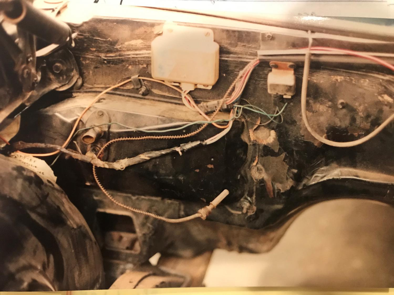

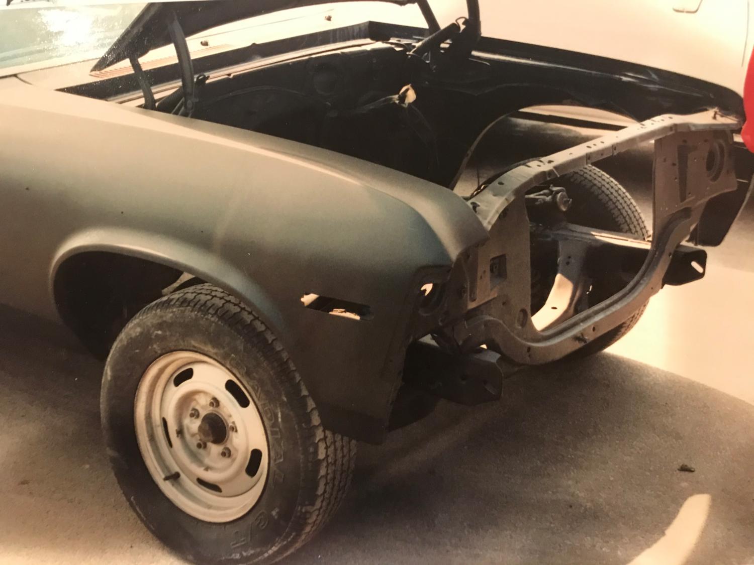

Car getting its GM wheelhouses and quarters bought from local Chevy dealer per notes. You can see the GM sticker on the wheelhouse

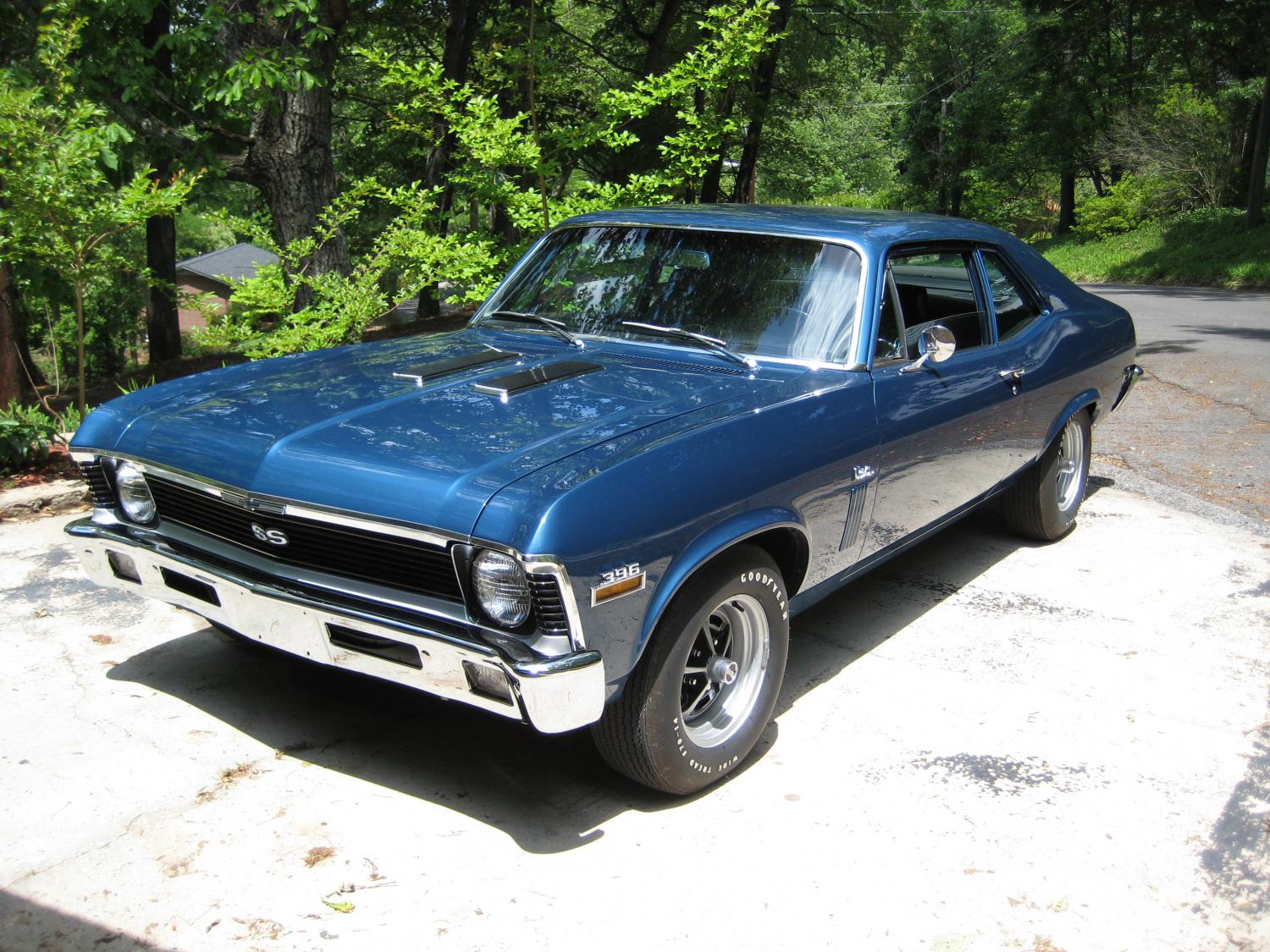

Final pic is car back from paint sometime in 1992ish--its born with color Fathom Blue. Paint almost 30yrs later shines just as nice with no rust or bubbling.

This car looks like the real deal in every respect...BB radiator support with the large opening and small holes for the rubber flap.

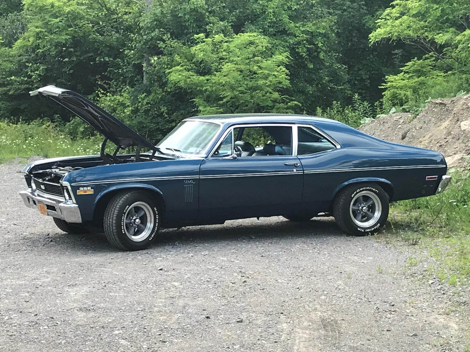

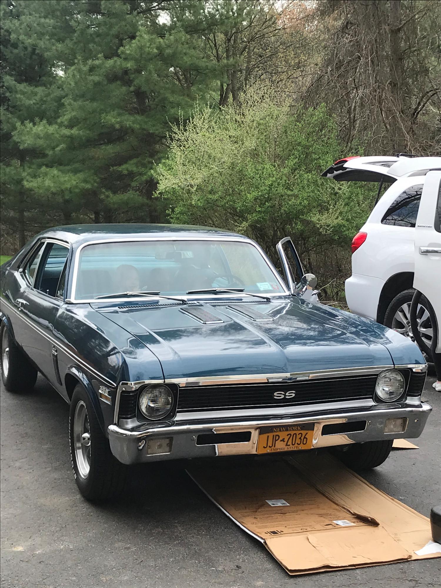

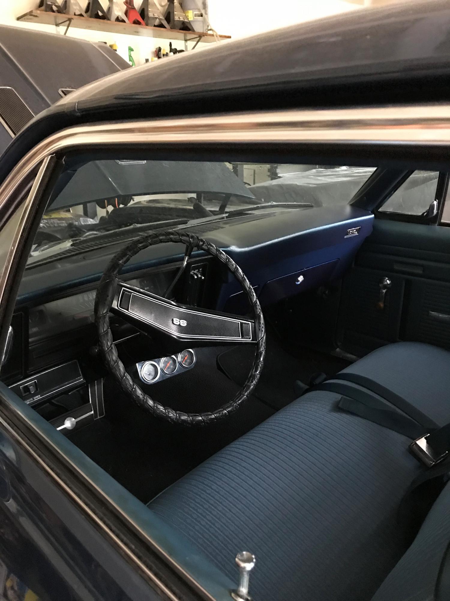

Thanks for the comments guys! Here are some recent pics. Trying to put together a set of poverty caps for the Spring
