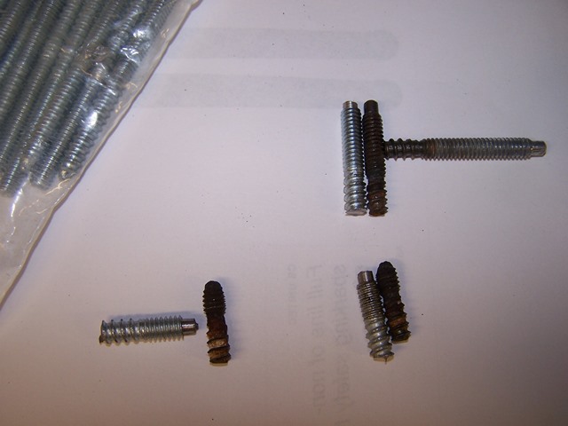

For a 1968 Stud I choose Mcmaster carr Steel Wood Screw Threaded Studs
Cut down and machined the nose of the 1/4-20unc end to replicate originals.
Do yours look like this?

Yes.
https://www.mcmaster.com/wood-screw-studs
When I look at ebay or Heartbeat the offered replacement studs have a hex flange, I am not sure of the proper stud on a production 68 & 69 Spoiler.
My 68Z w/ an Owner modified "GM" spoiler has the style pictured above & McMaster does offer the stud in stainless.
