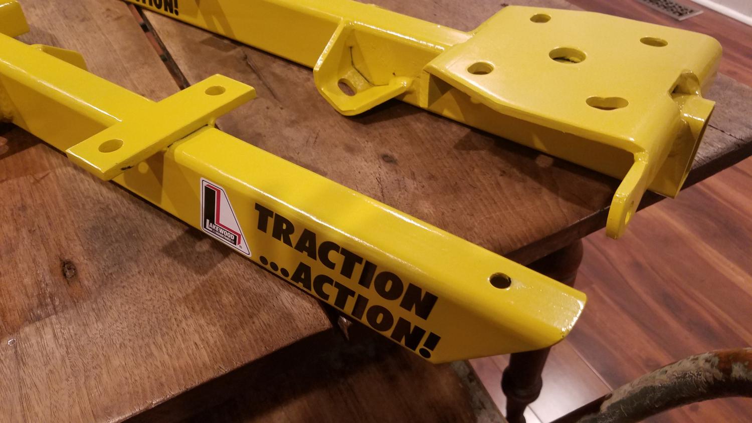

I did measure the distance from the inner holes for the u-bolts to the outer holes for the j-bolt and each of the j-bolt holes is 1.150" further outward. That's why there are such angles on the front legs of the j-bolts as they really turn in a lot to meet the eye holes on the front stirrups. I also tried mounting up an older set of original stirrups and they were tighter to fit and harder to align with the bolts than the NOS set I have here, so the NOS ones were used and they actually fit like a glove.
The bars came out pretty awesome. I've never seen them with the extra set of holes to add the J-bars in addition to both the u-bolts. Nice to be able to run both for strength. Is that just a different part number/style from Lakewood?

I’m pretty sure the 2nd generation of Lakewood bars which were rectangular tubing had the extra holes for the J bolts, it makes way more sense if you think about it, because if you ever broke a j bolt it could lead to disaster.
Grady’s bars are the original square tube design.
FWIW, I bought my first set of Lakewood bars about 72/73 and they were rectangle style, with the J bolt option.
The U bolts as well as the J bolts give you way superior clamping on the housing spring perches.
Glad it worked out for Graeme.

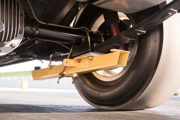

Hello Dave,
Grady's are the earlier square tube bars (Traction Action - Competition Bars) that came out in the 1968/1969 period and are quite hard to come by...not to mention costly. Although wider in tube design, they were also shorter in overall length. They could also be found with the wider (tapered) base plate and the outer J-bolt holes but were often altered with a narrowed base for both tire clearance and the shedding of excess weight by serious drag racers. The pair I had (shown below) were shaved on one side. This design was also available with or without the rear tails in the late 60s.
The style I have on this car is the second generation (Traction Action - Competition Bars) that started appearing in 1970 and beyond. They have rectangular tubes and are a bit longer than their predecessors measuring 33" overall from back to front. They also include the tapered 6" x 6" base plate with additional holes for the outer J-bolts. Most that I have seen from this period had the 6" tails and these were available with or without the rear straps to control the rebound. I think I have had 3 identical sets of these now and love this design although they are quite heavy.
I have restored both versions of the Lakewood Traction Action bars but prefer the longer rectangular design myself. In saying what I have come to learn about these bars, there are many people here who know a lot more about this stuff than I do since I was born in the mid-60s and was still wiping my nose when many people were racing while using these bars. That being said, I have studied this stuff well and I'm still learning about period-correct hardware whenever or wherever I can. As I understand it, there were many variations of the bars available over the years, and recall from using these in the early 80s that the later bars excluded the rear tail sections.
Also mentioned earlier in this thread, there was also the street master series which if I recall had a narrowed base plate and no provisions for the J-bar hardware. Most of the trac bar designs are very similar and many can be altered to fit different cars with the same direct purpose. Traction Action!

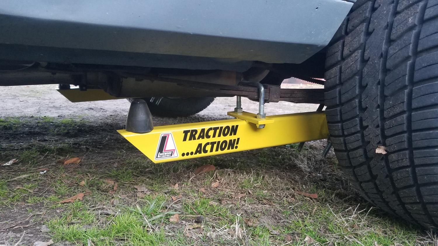

Very cool! I agree that it's a much better design for strength reasons. Makes a lot of sense. My 69 is unfinished day 2 that I drive alot. It's in primer still. I didn't come across any real Lakewood, so I cheated. I painted a set of CE2101 bars. They work and give the look at least...
Thanks for the explanation. I'm loving your build.

Those look good and I'm sure they work just fine. One word of caution if I may. You may want to consider trimming the tips on the J-Bolts. Depending on the length hanging down, those forward-facing legs can easily hang up on anything that goes under the car including speed bumps or road debris. I'd trim the legs back a bit for sure. Not too short though.

Absolutely. That was when I had just put them on before I adjusted them. I do still need to trim the bolts, but they don't hang near as low.
I had ridiculous wheel hop before I installed them. It completely eliminated it.
