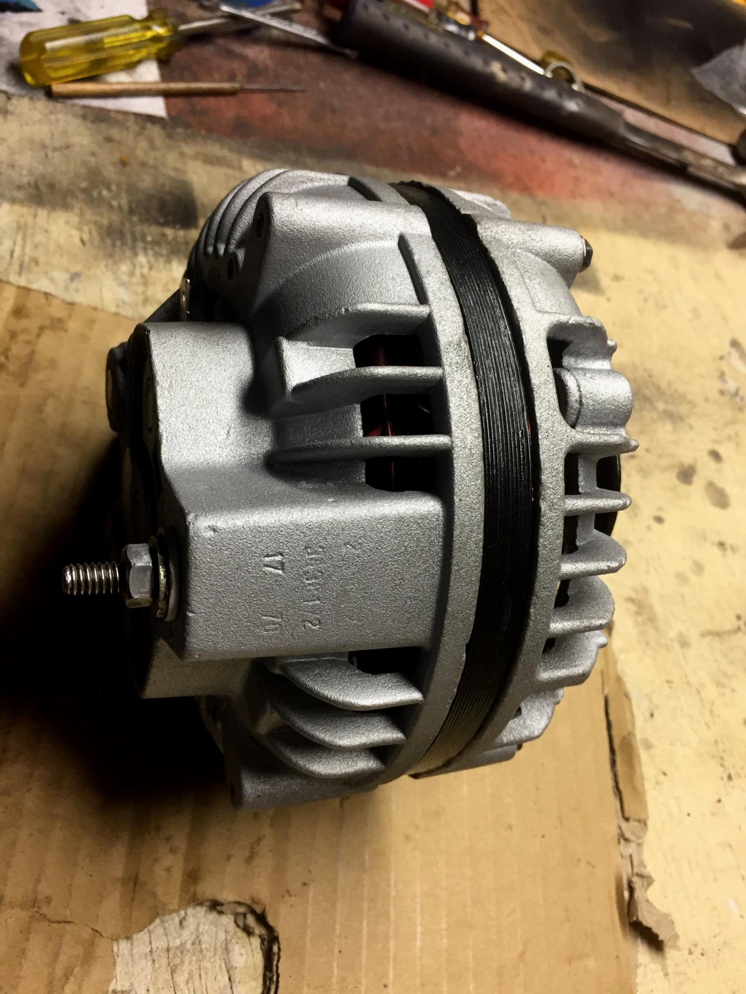

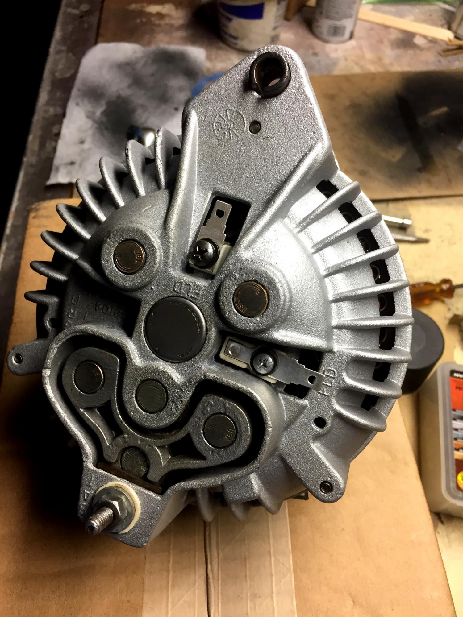

I have been waiting for the slow delivery of the alternator parts - new front and rear bushings and brushes so I could rebuild the alternator. It's a 1970 model with a date code of the April, 1970, just in line for the April 30 build date.
The circular casting mark with the "70" in the center and the 12 pie-shaped sections around it is the casting date code. You count the pie-shaped sections with "dots" in them to get the month. At the last filled-in month you count the dots. It looks like one dot in the fourth section meaning it was cast the first week of April, 1970.
The assembly date is the 17th week of 1970 which would be about a week before the car's scheduled assembly date.
Sadly, it looks like this alternator was rebuilt and heavily sandblasted long ago, so the casting marks are not crisp anymore. They also blasted the front casting code into oblivion. I had to heli-coil both front mounting holes back to the original bolt size. It's not the prettiest looking unit but it's correct for the car as it is an original roundback early unit. The later models have a square back without the visible pressed in diodes.
At least the original stamped steel, single groove, pulley was still there. All the modern rebuilds have a solid aluminum pulley that sticks out like a sore thumb on a restoration. It's the Mopar version of the Ford "CAUTION FAN" sticker on seen on every "concorse" restored Camaro. ;-)

Here's a comparison of the correct 1970 round back versus the later replacement squareback alternator (with the aforementioned ubiquitous aluminum pulley).

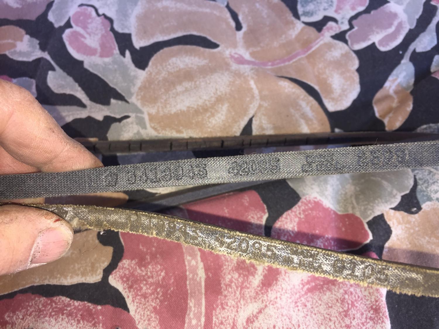

Potential cautionary tale on the repro belts, though. Now, granted, this occurred about 15 years ago, but I bought a couple of new (at the time), beautiful & correct-looking repro belts for the hemi (including 1 for a spare). Properly adjusted, at any significant rpm, it would just throw it (much to my surprise & that of Al Cocchiaro). Reinstalled & readjusted = same result.Tried the second one = same result (again).
I replaced it with the new-from-Chrysler (non-correct-looking) equivalent, and, have never, subsequently had a problem. Perhaps, "these days" they've scienced 'em out better, or, perhaps, what I had was just the proverbial "bad batch," but if you're on a shakedown run, be sure to bring yer tools, just in case you're on the receiving end of a less-than-desirable occurrence. (At least, the current weather up our way isn't so overheating-potential friendly!)
…And, if, perchance, it/they do prove problematic, you can always install it for a show (which is why I kept mine)!

It's a Quanta brand repro belt. Dave has a spare one still in the package. We shall see if this one ejects once the roads clear up in a month or two. From the interwebs, it looks like you're right about them not staying put under actual operating conditions. Just for show I guess.

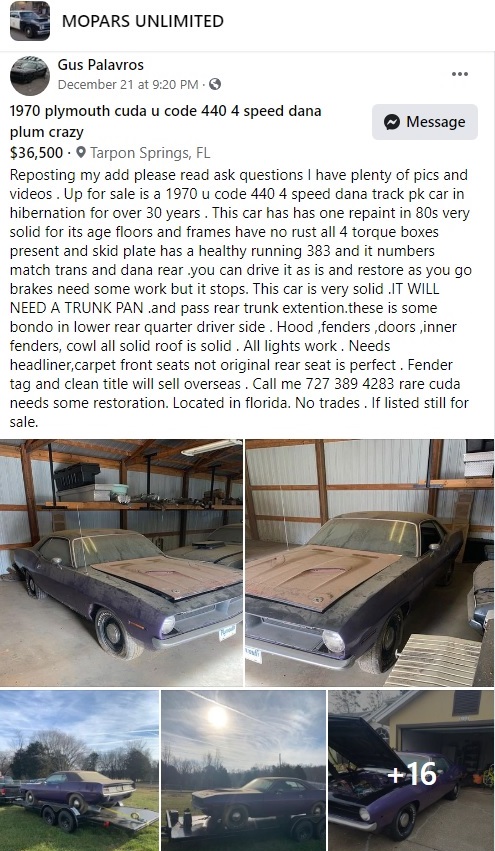

OK, where's Dave? We need to start on Purple Part Deux:
I found this one on facebook (I posted more info in the ebay sales section of this site). https://www.yenko.net/forum/showthre...46#post1528346
A very rare: 334 built - 440 4bbl, 4-speed FC-7 purple cuda down in Florida. Looks like a really neat car and it was built one day before, and 4,000 or so VINs away from my purple cuda.
Somebody buy this!
