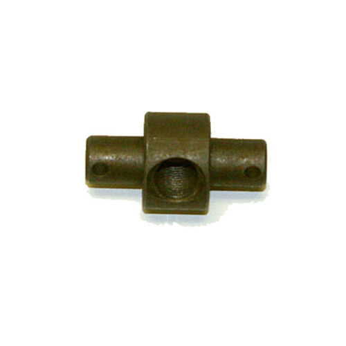

The next project was gathering all the parts for the steering column lockout system that was unique to 1970 Mopar four-speeds, and extra unique to small block cars. When working as designed, it requires the car to be parked with the shifter in reverse, and then locks it there when the ignition key is removed. All these parts were usually tossed in the trash can the moment someone tried to install headers on a car. Luckily the car had 95% of the parts intact (Thanks Dave). The only pieces missing were a couple of plastic bushings for the cross bar and a unique double-headed shifter linkage swivel that the lockout engagement rod attaches to on the reverse lever. I actually found them both on ebay - the Hurst rebuilder guy sells the swivel and the bushing from a Mopar supplier. Here's a photo of the swivel and the linkage:
