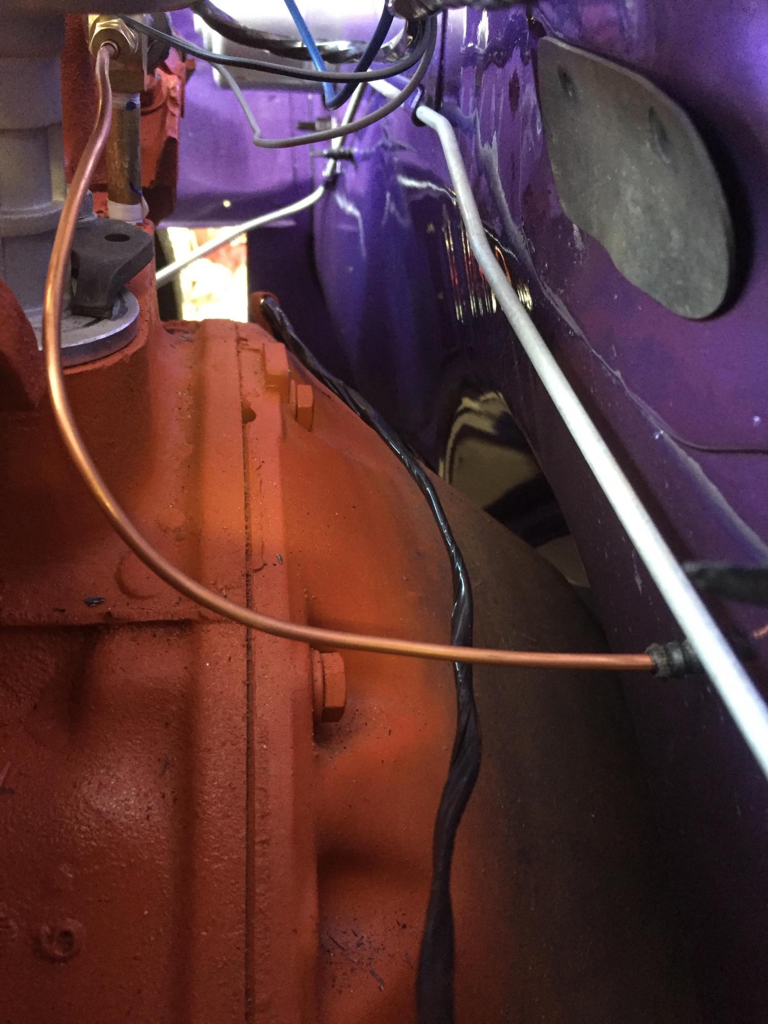

Look what arrived today! In continuing with my Day2 theme I found an original 1970's Stewart Warner Stage III oil pressure gauge on ebay for $35. I had one of these in my first car - a '69 Camaro Z11 pace car back in 1977. They came out in the very early 1970's and were available into the early 1980's. This one is dated May, 1979 (my junior year of high school).
I also found a spare block off plate for the standard gauge panel for $25. This goes where the optional clock would have been if you paid the extra $$ for it in 1970. The block off is made of molded plastic so it was easy to Dremel out the circle for the oil pressure guage to snap into. This is exactly what we all did back in the 1970's. Back in the day, it was actually rare to find a standard gauge panel that didn't have the empty block off plate bored out for an oil pressure gauge or a mini tach. I will run a copper oil feed line instead of using the 41 year old plastic tubing in the gauge kit.
(Note: no dogs were harmed during the photographing of this oil pressure gauge)

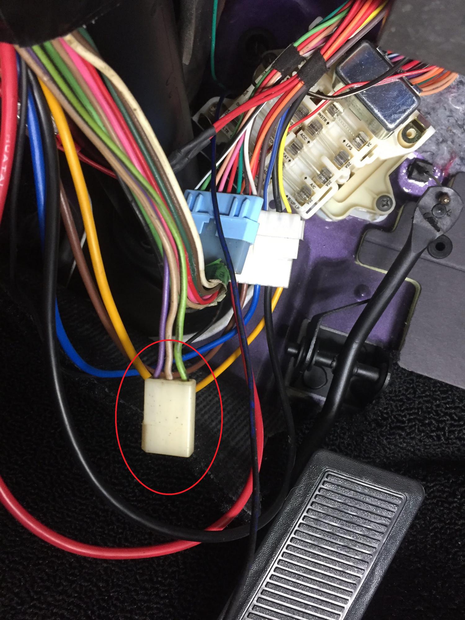

This should go in this weekend before the steering column gets reassembled and installed. I also found the built in tach lead in the engine compartment harness. It feeds an empty spot on the bulkhead connector at the firewall. All I had to do was add the interior side portion of the wire with the corresponding connector and I have the tach lead already routed without having to fish a random tach wire to the coil.
As you may recall I am installing this 1972 Mopar tach on the column, just like the old days.
