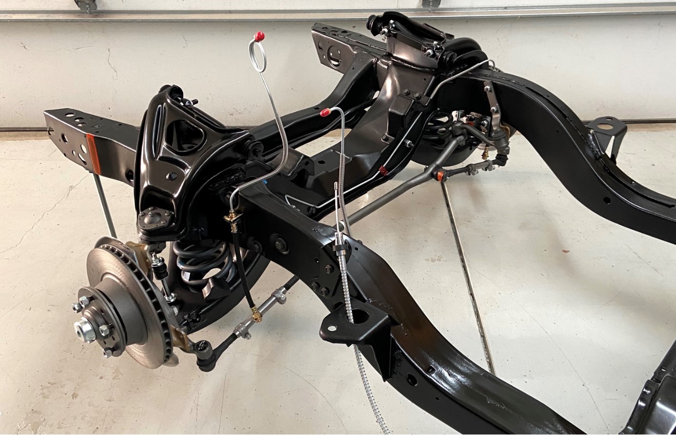

The 3908391 casting # pitman arm on my Power Steering Z has a lot of slop in the stud. Who can rebuild these to keep my original arm in place?

Ready for the steering and brake component projects.
Looks very clean and nicely done. No issue but if planning on any judging a-arms were painted assemblies so the dog bones, washers and bolts should all be black.
I’ve gone back and forth on that 100 times.
And thank you for your build thread and advice. I use it all the time.
Will probably end up black or maybe something like 90% covered. Looking at survivors it seems like the factory guys were not too careful regarding coverage in that area. My initial attempt to satisfy my personal taste vs correctness was to do the bright washers and bolts in phosphorus.
I am real happy with how the springs came out. Did a lot of blending and experimenting and they have a little bit of heat treat bluish tint in the right lighting.

Personally, I've always liked some contrast in the engine bay and on the steering and suspension. If it's going to be judged, go factory spec by all means. If you like contrast, add some phosphate, natural and cast finishing so everything is not just black paint.
All depends on the look one is going for, but I like this one. Just sharing my opinion.

Sort of hijacked my own thread, but still wondering if the ball joint can be saved in this pitman arm.
Thanks for all the input. Despite personally liking the contrast in the A arms, I did ultimately decide to do it right and have redone that part of the work. When I get some time, I'll post some more photos and details of this project.
