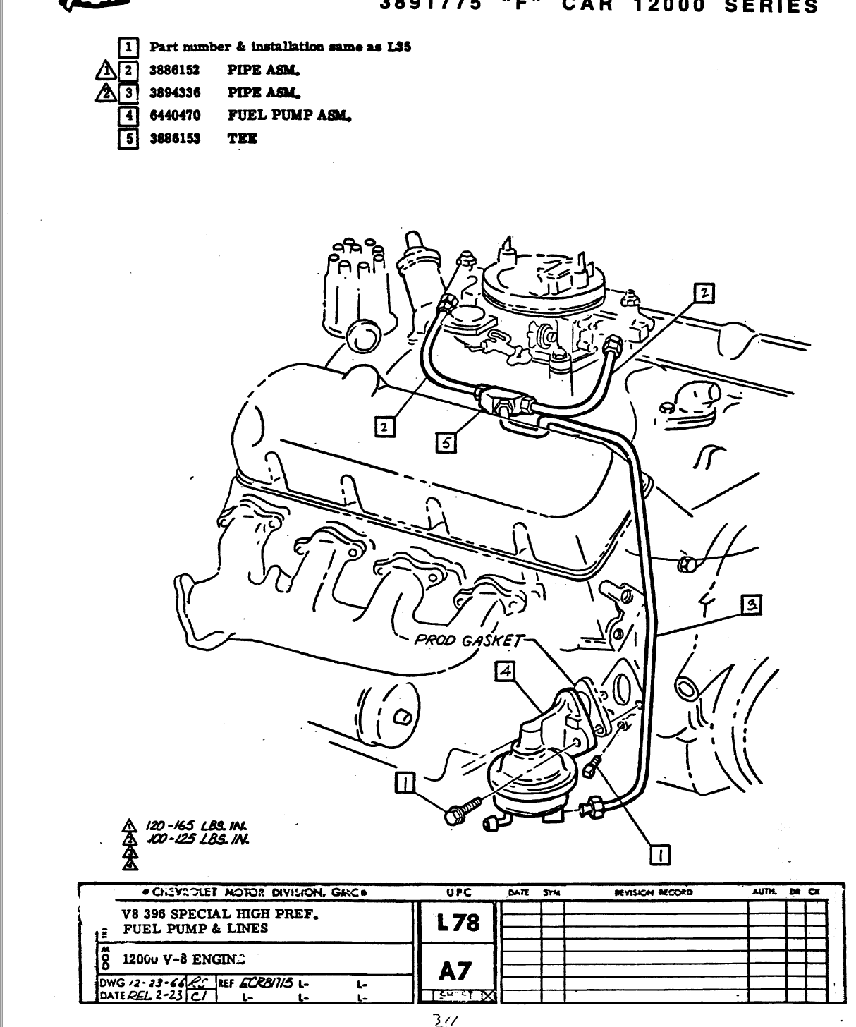

The pump to carb line is repop but so is mine and most you see. Is the radiator fan shroud GM or repop? Hope it’s GM cause real ones are hard to find and very expensive.
