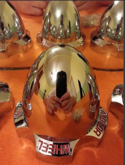

This was an NOS set that sold for $1500 a couple years ago

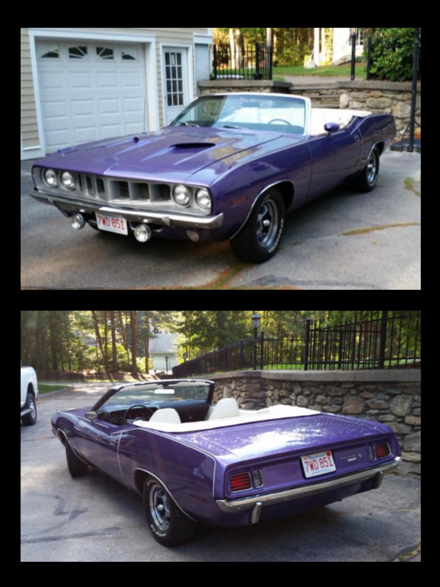

Nice photo! Who's purple 'cuda is that? Needs the red drums and Polyglas'es, though. :-)

Purple Cuda w/ Spyders just a pic I Googled up, '71 Ragtop as fuzzy pics below.
You're so right on the red drums and Polyglas!

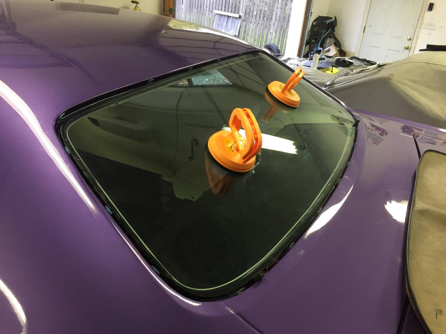

Next item on the list is to install the rear window. I bought a couple suction cup glass installer tools at harborfreight the other day in preparation for the install. The 5/16" butyl tape also arrived yesterday.

A hint on the glass install...drop the glass in and measure any low areas around the perimeter before setting the butyl on. I've had to use a combination of 5/16 and 3/8 to get a uniform bed.

Installed the rear glass today. Rather uneventful. I rolled out the 5/16" butyl tape and then applied the suctions cups and plunked the window into place. It touched the tape almost all the way around so I then started massaging the edges to get it to engage the entire circumference. After a while the weight of the glass did the rest of the work and there is a clean engagement line all around.
The problem now is that the rear window stainless is rather mangle-ated. There's only one large ding in one piece but it is all rather too "twisty" to use. I don't want to risk chipping any paint so I am on the hunt for a nice straight set of moldings. There's a few on ebay at the moment.
And before anyone comments, yes it does look like Linda Vaughn helped me install the glass on the passenger side but leaned in a little too close.
