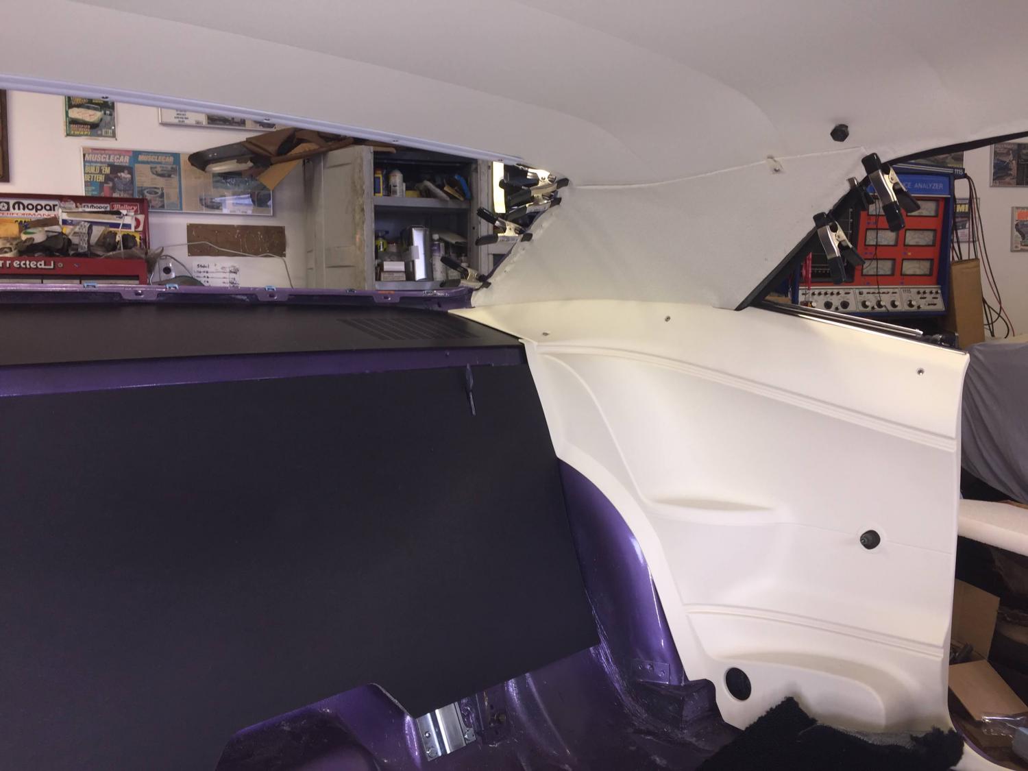

I also decided to give another try at getting that repro sail panel material onto the original fiber-board molded sail panels. The key was borrowing one of my coworkers portable steamers (for getting wrinkles out of clothing). It worked great! It is designed to be used while it is pointed downwards, so it was a bit hard to use on the actual headliner to get rid of the folding indents that wouldn't initially "pull out". So a lot of flipping and tilting got those pesky last creases out of the actual headliner.
As for the sail panels, I ended up steaming the heck out of the material and then using a lot of the heavy duty clips to temporarily hold the two opposing sides (top and bottom) that are actually glued to the board. After clamping them, I carefully removed each clamp one at a time and applied some adhesive to the board and the overlapping edge and stuck them together and reclamped them. The front edge glues onto the quarter window frame while the back edge tacks onto the spikes around the back window frame. After several hours of massaging the sail panels while watching the Goodwood Festival on TV, I had the sail panels ready for installation.
I test fitted the rear side panels which also served to position the lower edge of the sail panels as well.
It came out pretty well. Now hopefully I can cancel the order for that extra material that they haven't shipped yet.

And I installed the package tray and the rear bulkhead insulation panel. (After removing the interior panels for the third time, because they both go underneath the panels).
BTW, does the black cardboard or the jute insulation side face the interior or the trunk?

I got an answer from the E-bodies.org site: E bodies didn't have jute backing on the cardboard bulkhead panel. So I'll just flip the panel so the black side is visible in the trunk.
