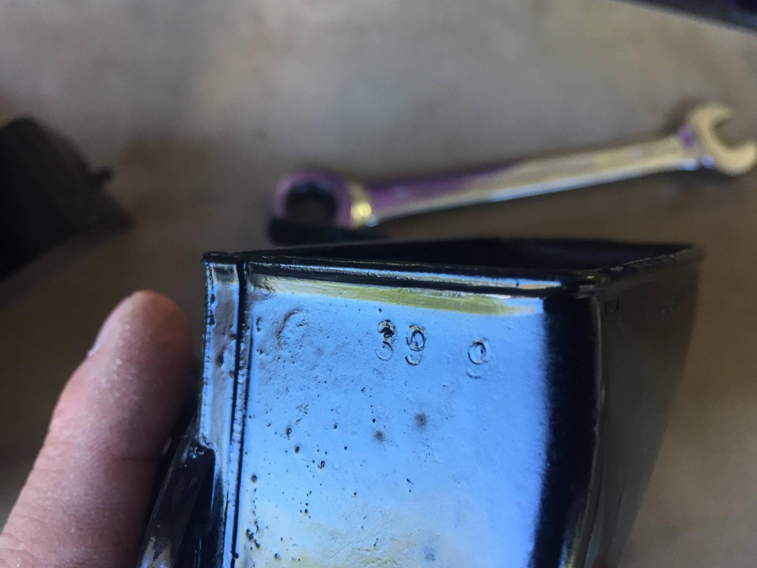

here's that clip I need.
  #730
Old 10-04-2020, 06:26 PM
njsteve's Avatar
njsteve njsteve is offline
Join Date: Nov 2003
Location: NJUSA
Posts: 8,493
Thanks: 9
Thanked 3,019 Times in 924 Posts
The saddest photo in the universe. If only I had a time machine to go back and find the broadcast sheet that was taped to this exact spot while it was rolling down the assembly line. You can see the tape and sheet fragments where it was stuck on there back in 1970.
