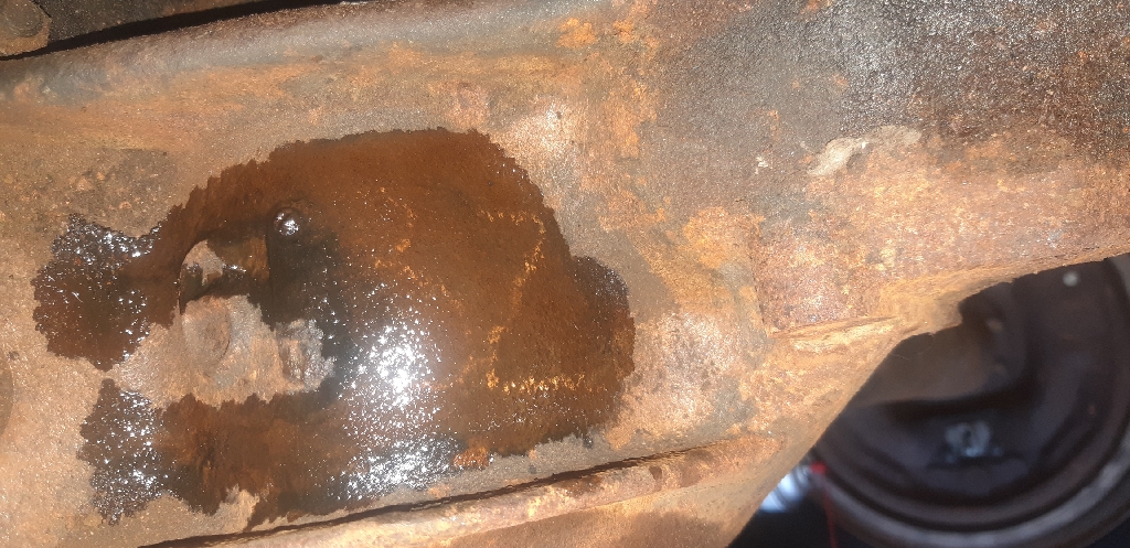

If you're like me, which I hope you're not for your sake, it's like Christmas degreasing parts to find factory markings all over the place. It's amazing to me that they'll still be markings left even after all these years and rust! I've never seen a couple of these marks before. The large "32" is a new one. Being a 3.23 gear, maybe it is the first two numbers of the ratio? Courtesy of RS_COPO-Canuk, I replicated the factory stripe color too!

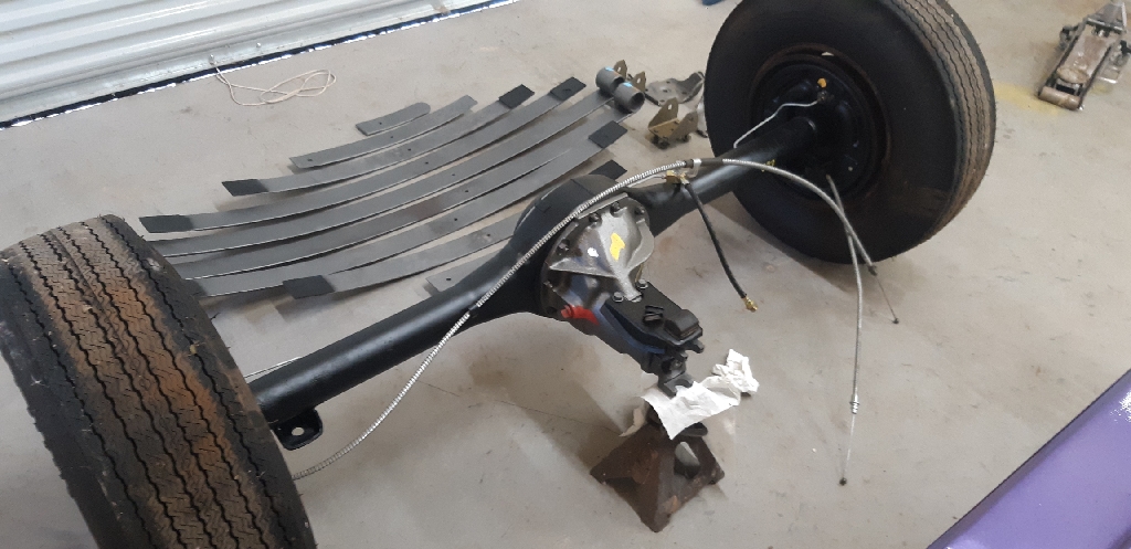

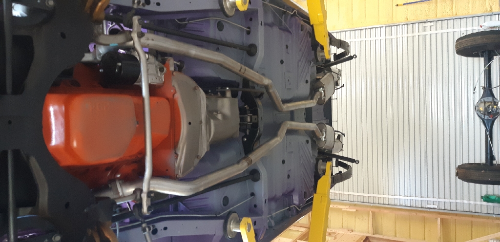

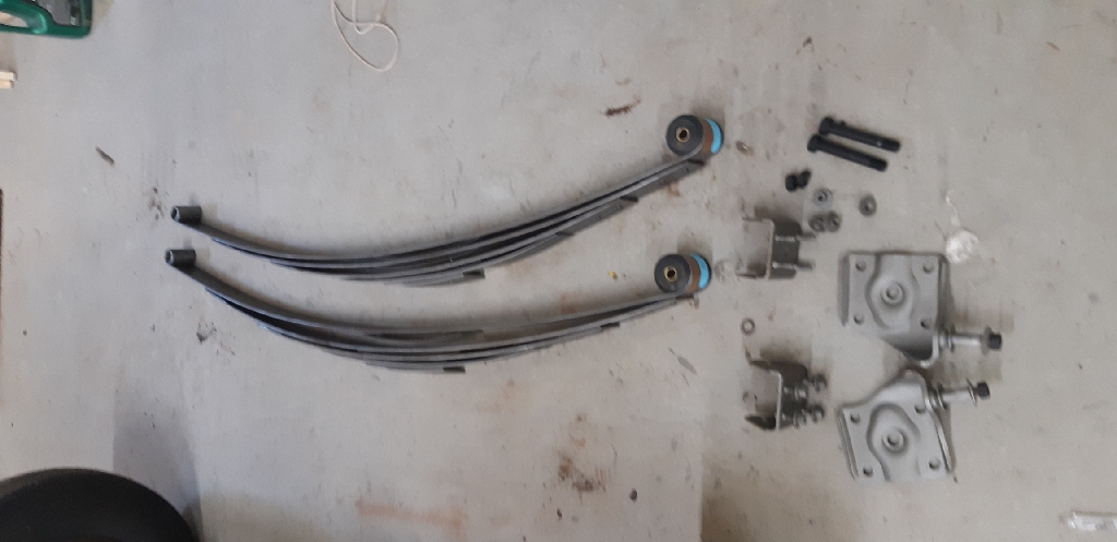

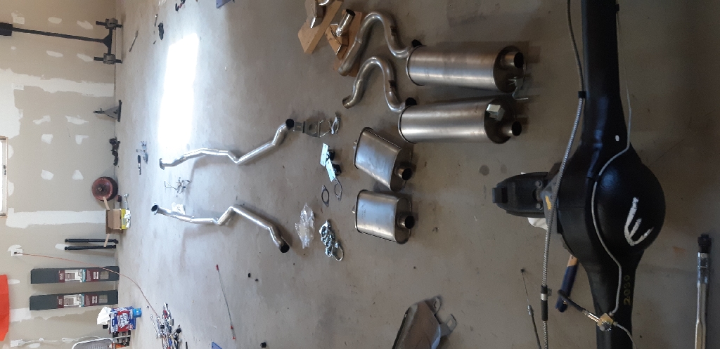

Springs are installed and still waiting on new u- bolts do I can install the rear. Meanwhile, the exhaust is going in!

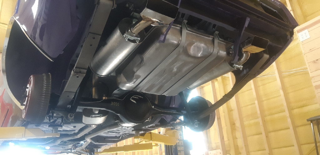

Moving forward, the infamous U-Bolt debacle of 2020 has passed! They finally arrived and the rear is back where the rear belongs... in the rear!

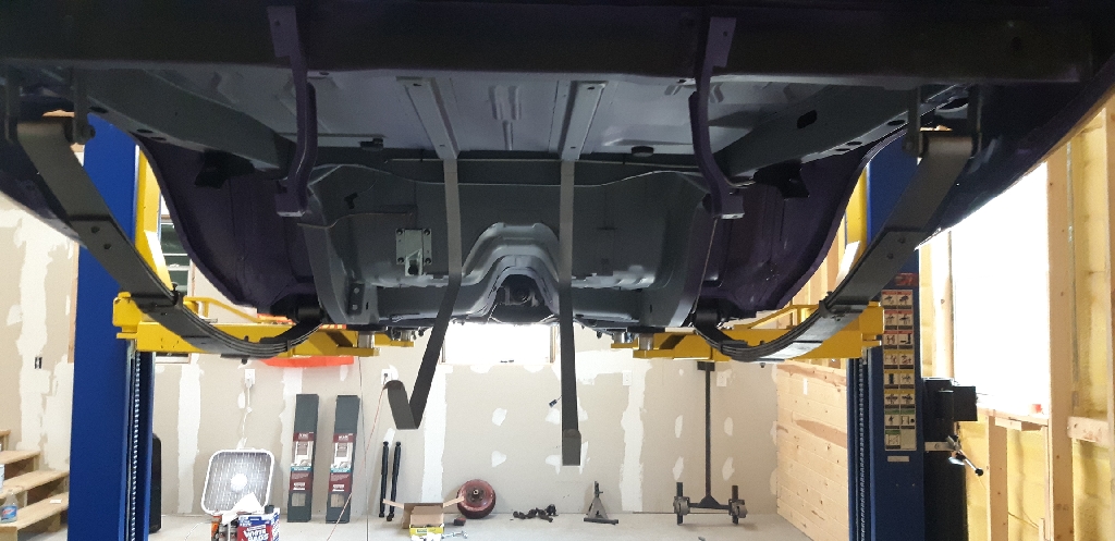

Since the part of the trunk floor that I replaced was the area where the exhaust mounted, I had to assemble the exhaust, install the valance, align, mark the holes for the mounting brackets, remove the valance, exhaust, drill the holes, reinstall the exhaust, valance, align everything, then tighten. Easy... freakin' peasy!
It's coming together nicely! Is it perfect? Nope. Will it win best of show? Pfflppp... Will it make Steve's Dad finally lay to rest his purple car fix? Definitely!

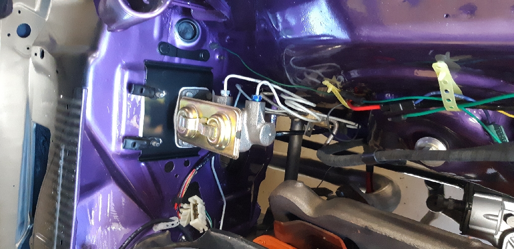

Engine bay is buttoned I up with all brake lines hooked up for Steve-O to start the bleeding process. Wheel lip moldings installed, and up next will be the undercoating in the wells. Once the bumpers are done, the da ssd's h will be loosely placed in along with the steering column, seats, aged the remaining parts awaiting pickup!
