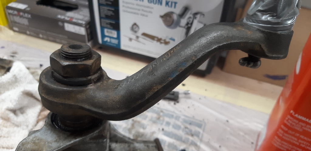

Correct-O, Steve-O! Those go on the inner and outer tie rods as well as the pitman and idler arms. Or maybe the pitman arm gets the standard castle one? Jim...HELP!
Ball joints get the other style, and it’s good you have those since you’ll have to replace a few “non-correct” ones since some were missing when I got it and James had the front held together with lug nuts!

Now that you mention it, was that blop on the center link on one end where the steering box connects? I thought I saw remnants of one, red like the end link adjusters nuts are, on one end or the other but just thought it was something else. Where that blop be located, oh Mopar Master of Megatronic Magistry!?
Cheers
Dave
Good on the Tri-Castle!
Actually there is usually a big paint splotch on the center of the center link. I'll see if I have pics of it - and the color....

Found a powder blue splotch on the pitman arm, and another marking on the K-Frame by the steering box mount extending to the engine mount on that side. Green. That makes two marks on the k-frame I've found.
This front end (balljoints) was never taken apart. I think the uppers and lower ball joints have the standard castle nuts but the pitman arm, inner and outer tie rod adjusters have the tricastle nuts. Of course, you can modify the standard castle nuts to tri castle style if need be!

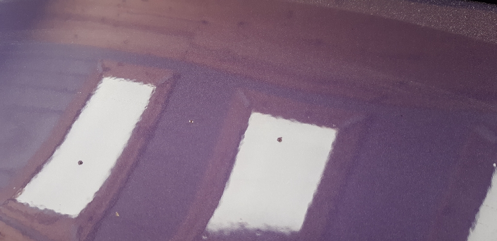

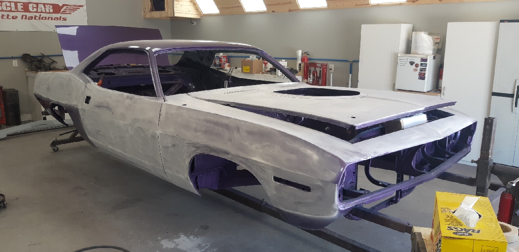

In other words, paint part deux is on the way! Yes, while it is probably the flattest paint I've ever shot with no runs, sags, drips or mottling on the color, there's 5.7 bugs per square inch and it's simply not acceptable to me.
I rushed into the paint and sprayed at night since during the day it's been 100+ here. That was the first mistake. The second mistake was living in central Texas where all the bugs are not only bigger, but minuscule as well. This coupled with a combined total of 64,000 LED lumens equaled a bug fest bug fest not seen since the last Democratic National Convention!

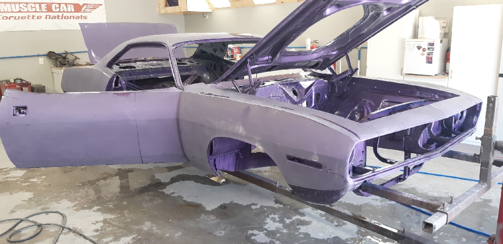

So with that, out came the DA with 320 then 400 and everything got sanded flat again. Eeeeevvvryyyy bug is out and it'll be a masking fest not seen since the Elizabethian era! A quick shot of base to even things out and then clear should be all it needs. This time I'm painting in the early morning which I should have done the first time. The temp will be down and no bugs. Luckily I had to do this exact same thing on this 1970 Charger that I painted about 10 years ago. Way happier the second time!
Steve was very understanding and even offered to pay for the additional materials. But, no deal. This is my screw up and as such, my responsibility to fix it at my cost, not his. I mean, ALL shops do that, right?
So Dos Paintos Purpolous over the weekend. Then reassembly begins!
