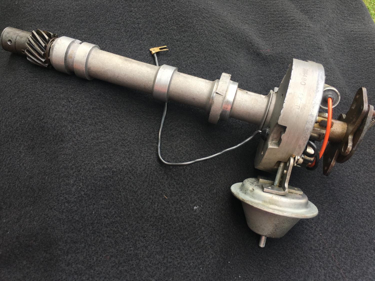

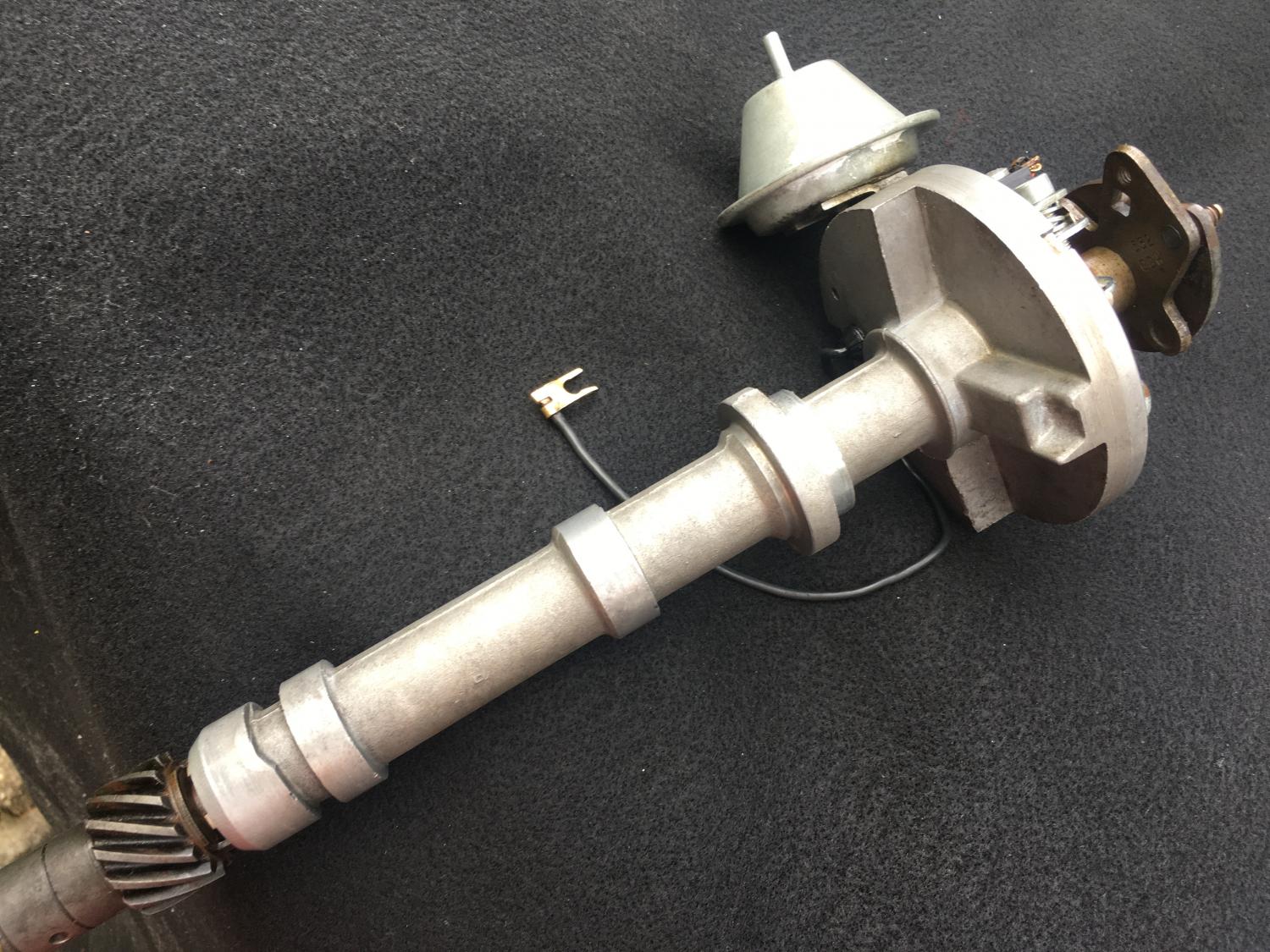

I have someone interested in this distributor. I wanted to get sharp eyes and opinions as to its authenticity. I am fairly sure I’ve had this distributor for 35 years. I am more concerned with giving the buyer peace of mind. TIA, Rob.

Looks good to me Rob. Stamp looks good, has the right vacuum can, 532 cams and it's very clean!
Nice piece!
Nice piece!
Agree, Legit Distributor.

Real Deal.

Looks good to me also Rob. I like the "weaker" original GM stampings.

Graeme, Rally, Lynn and Sam, thanks. Much appreciated, Rob.

I have a 8k30 in my Z28

Agreed VERY nice clean housing.
I see it even still has the cam lubricator wick in place.
