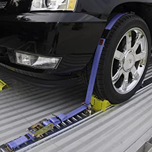

Planning ahead for when my car will come home with me. I have a 20 ft. enclosed trailer, nothing fancy but it is lacking what I think are adequate tie downs. Obviously I want to be able to safely anchor the car to the floor but also don't want to damage my subframe/axle finishes. Should I install some E-track and use tire straps? What are some recommendations from you guys that do this successfully?

In my neck of the woods, it is now law to have at least two opposing tires strapped down. You can do all 4 and eliminate the frame straps, but do not use e-track. Install proper D rings that are installed to support the required weight.
Or you can safely use these MACS straps to tow from the frame rails. I've never had a problem using these in the past.

e track and over the tire e track tie downs. No crawling under the car or any straps touching any painted part of my cars. The only way to do it.

I love my E Tracks. If you have cars wider than Camaros - it's a little tough to access the wheels to get the parts secured in my enclosed trailer (at least for an old guy like me!).
