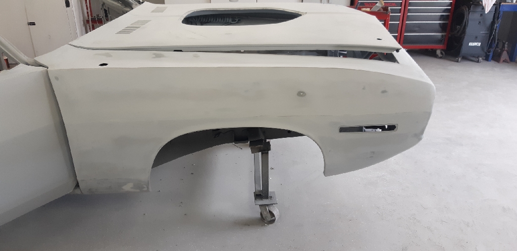

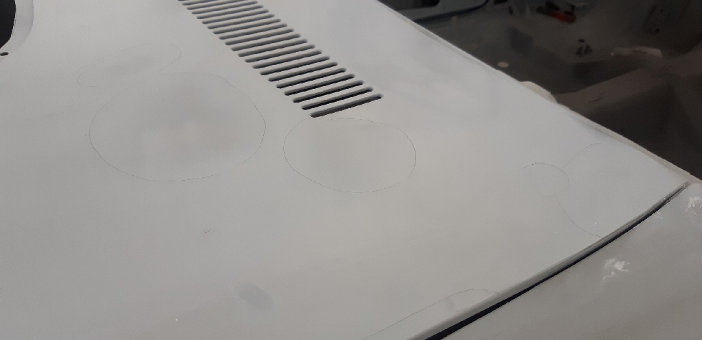

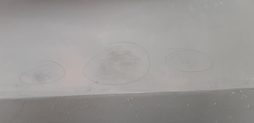

...aaaaaand another 8hrs of blocking. Ugh. I'm telling ya, this could be the best new cardio-workout ever!
Here is the start and the low spots on round 2 of 220. They're getting less and less but then others pop up where none were before! This is some sort of Ethic Far East Aqua Persuasion (that's about the best I can do to be politically correct) for sure!
But this just in, Steve said he's going for that "Day 2" look, so the bucket of white house paint look it is! Phew! Now I can relax and paint it tomorrow!

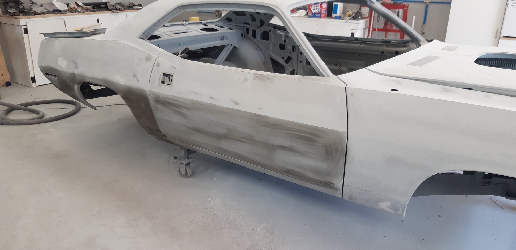

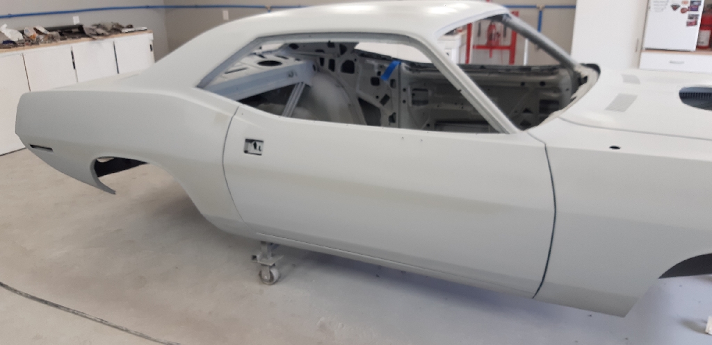

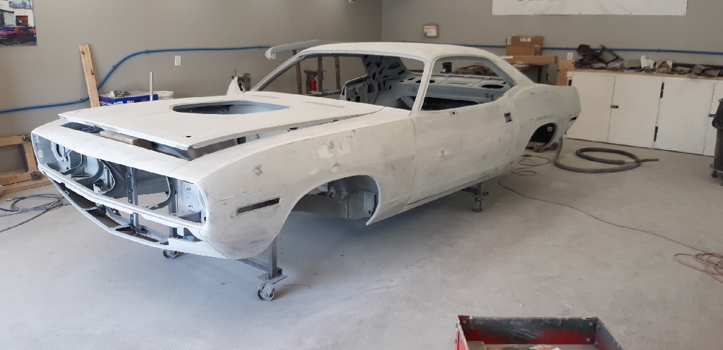

Final 220 block and then prime!
The lower rear valance was really fighting me, so this side is way better. Need to work on that body line, but the gap is way better. Next up... the other side!

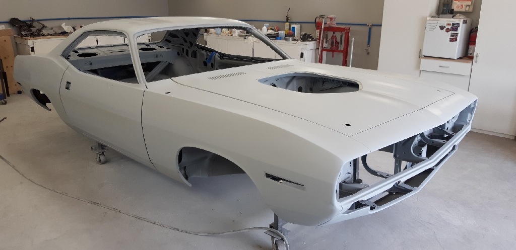

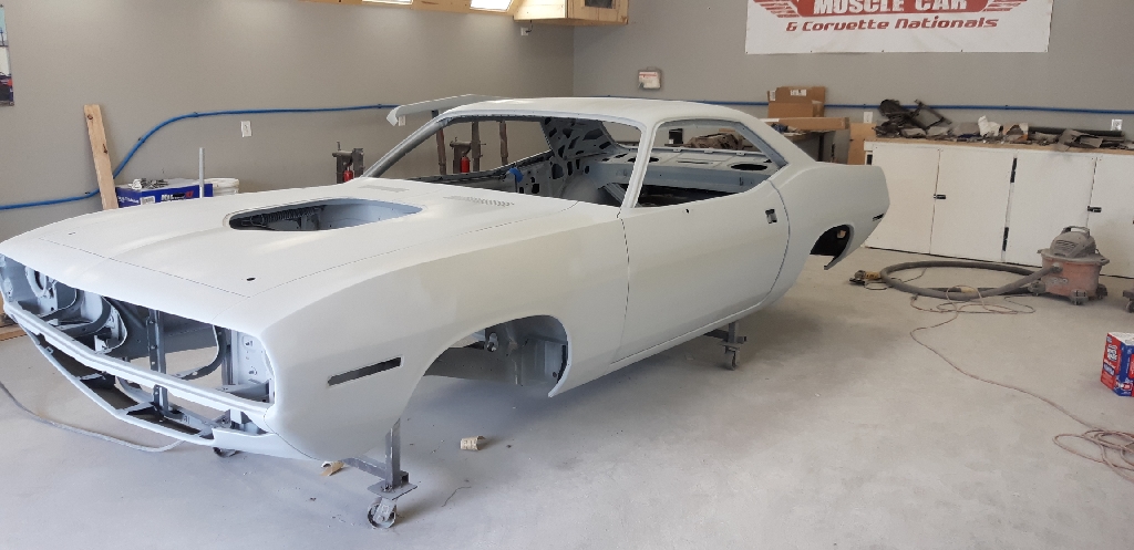

The front is now down to 320. Way happy with the body lines. A few dings still to smooth over but not many more left.... finally!!
I'm rolling into days off and with out any major issues popping up I should be ready for paint by Thursday. No, Steve...it won't be painted Thursday, but definitely this month! Woohoo!! I needs to head up to the paint store for the final round of supplies.
What's next? The car gets rolled out, washed, then I will take the air gun to it to blow it dry, then a wetsand of 400. Then another wash, then a go over with a pencil and a shop light to look over for any pinholes I may have missed. Probably one last light prime followed by another 400 wet round to make sure it's ready.
