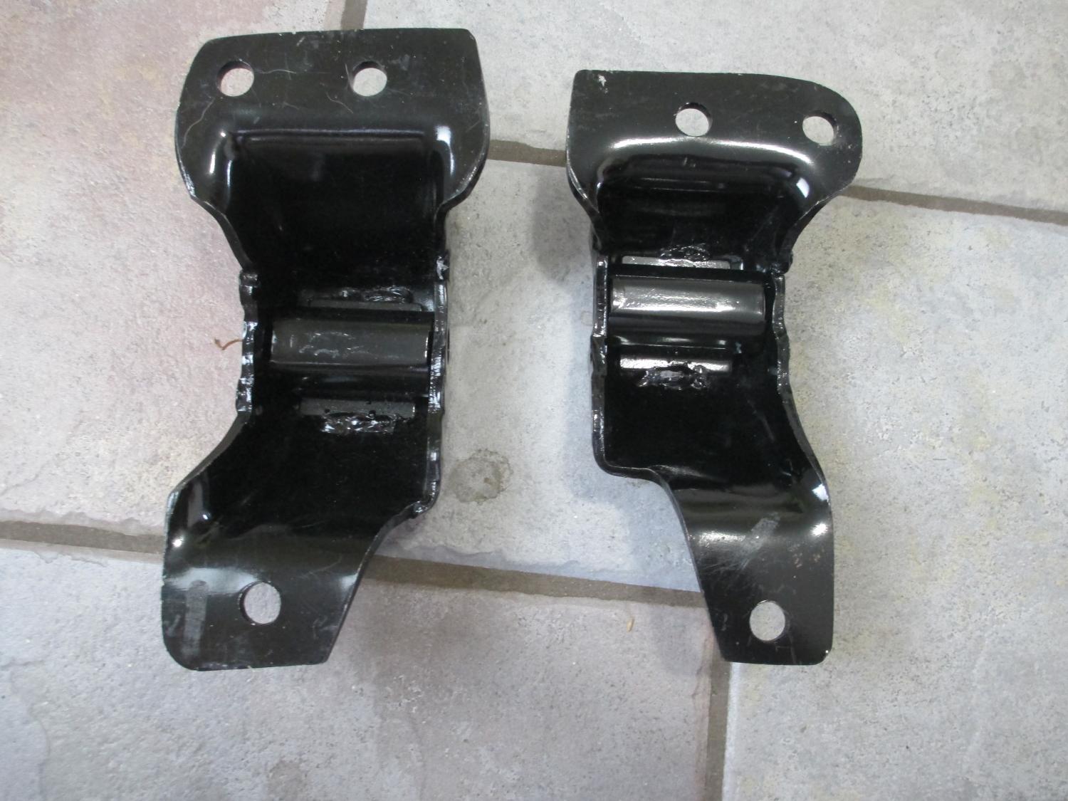

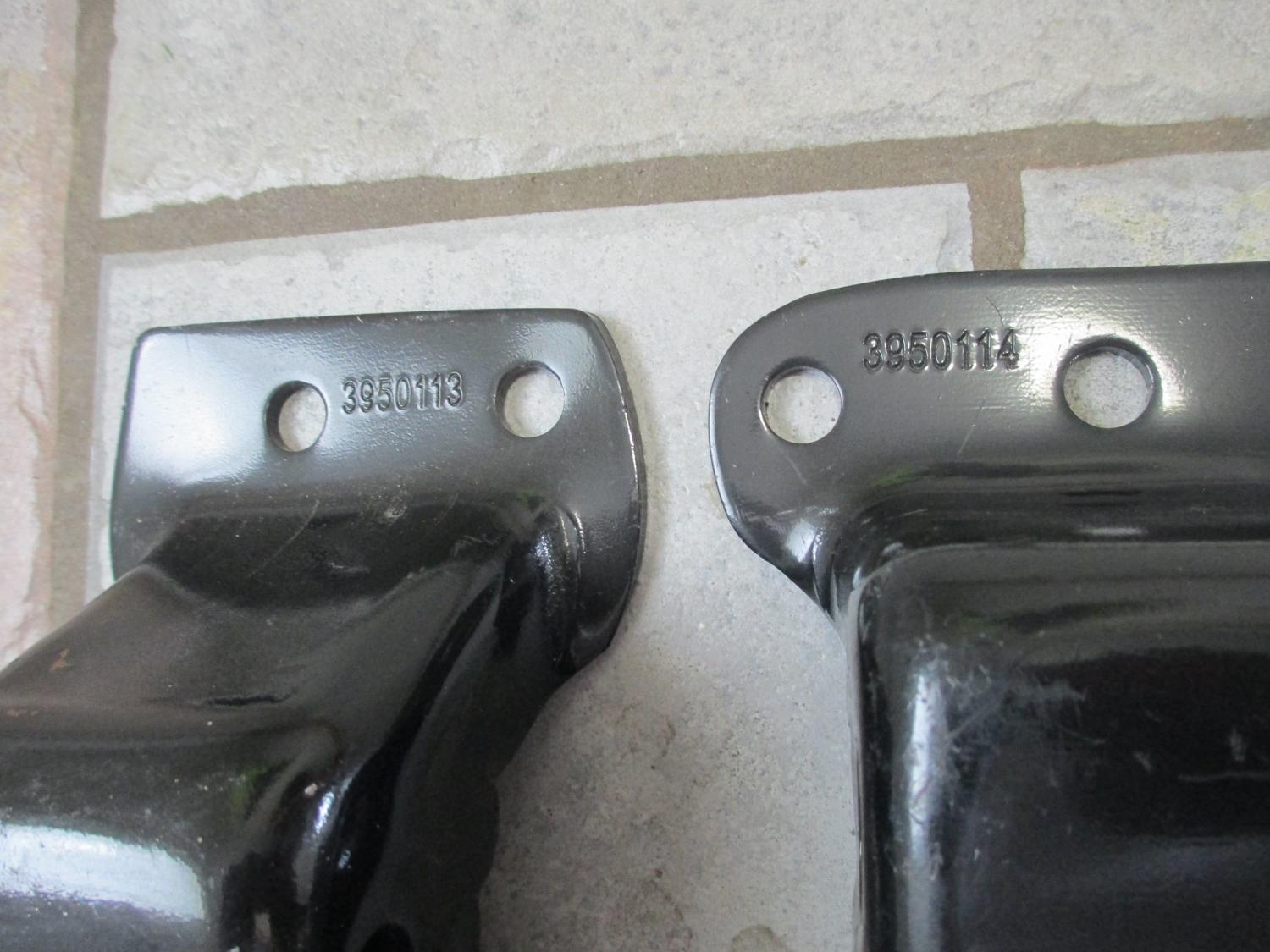

Easiest tell tale is the wrong fonts and the numbers are too big. Also repos dont have complete or correct radiuses .
