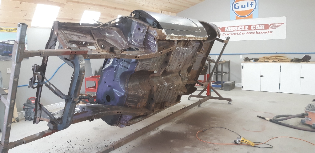

I just love that pristine, original purple under the undercoating! Let's see more.

Oh course mid-stream into this I get summoned for a trip, but moving forward with the Undercoating Reduction Act passed in 1992, undercoating removal has started! A propane torch and a couple sturdy wood paint stirrers fo the trick along with various dental style picks to get in the grooves and such. I'll wipe this down with brake/parts cleaner (it melts this stuff! )out of the spray can and I'll be ready to hit the other side.
So interesting thing on these Mopars much like I documented on my Bee: the undercoating was the last thing sprayed on the car and as such, it got some overspray on the fuel lines, brake lines, gas tank, leaf springs, and heck, even wheel lip mouldings and rocker pinch welds if the guy got too happy with the Shutz gun! You can see the shadow of the the front to rear brake line on the driver's side rear frame rail.
I think this took off 4lbs of weight from the car which should lower Steve's times by at least .000001th. And due to the Undercoating Recycling Act passed in 1993 this will all be melted down and sprayed back in the wheel wells when done!

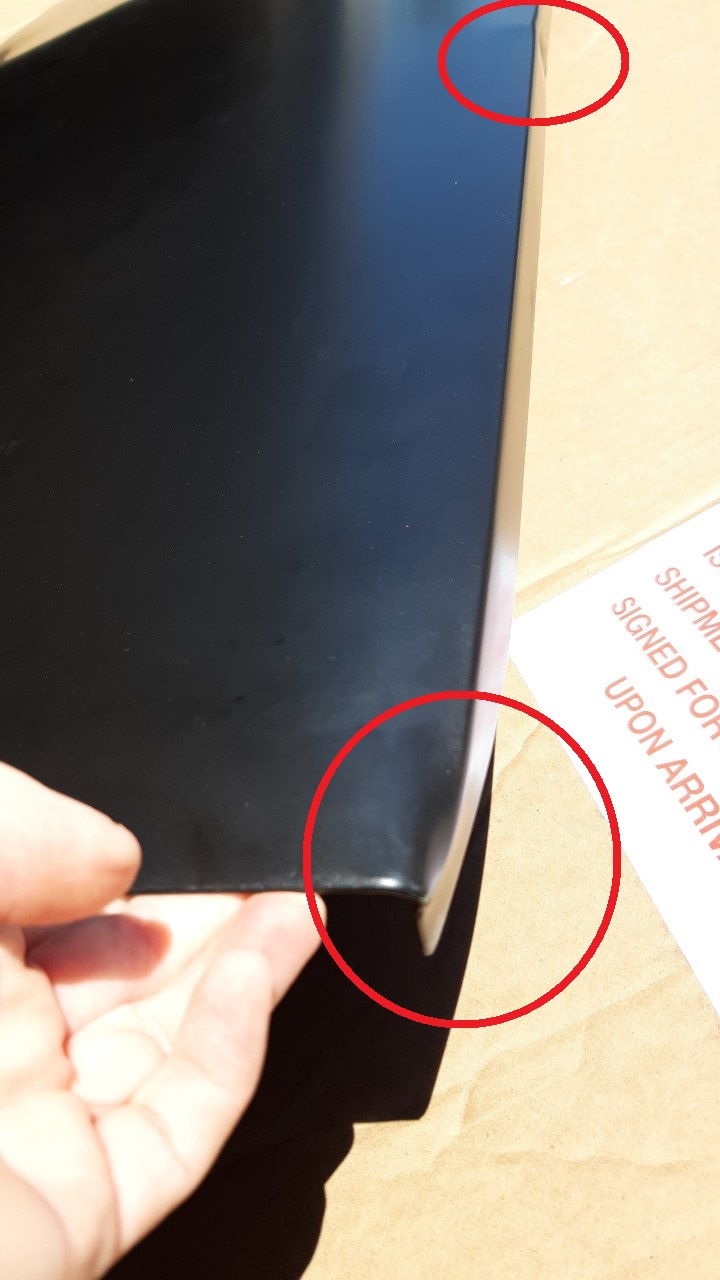

Brand new AMD trunklid showed up at Dave's place today...here's the photo taken by his better half who promptly told the truck driver: "Heck No!" and refused it.
Let's hope the replacement is better. Though the guy at the AMD distributor said that they had ten calls today about panels arriving damaged. I hope there's not some job action going on at the AMD warehouse or the shipping company they use?

I just got an email update from the supplier of the AMD trunklid. New trunk lid is on its way out.
It seems that the warehouse recently hired several new employees who were not trained in any sort of procedure on how to handle valuable sheetmetal, and that was the cause of the slew of damaged shipments that went out.
I assume they are now former employees.

About 95% of the undercoating is off courtesy of propane and propane accessories, along with scrapers and picks!
The next phase is the wire wheel on the grinder followed by a chemical wipe down to dissolve the remainder of the nasty goop. In the crevasses, a spot blast gun with some good ole 60 grit slag to get into the nooks and crannies.
Should be 'rollin phat in epoxy shortly! Couple small areas I will have to break out the hammers on. A pushed in floor corner and the driver's front frame rail shows some pretty good jack damage. But fear not! It'll be fixed poste haste!
