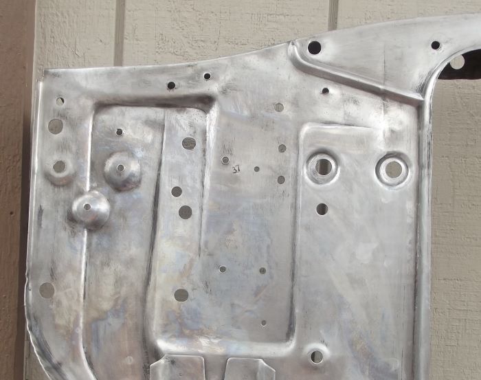

Any pictures showing exactly where the date stamp is William? Inside of the core or the outside face...and its positioning in reference to the VR location?

Graeme, Gradys 69 Camaro. #37 th week.....and, your Zee is looking great

Looks like mine is stamped 43 for the 3rd week of October. Thanks for that location as my eyes aren't as sharp as they were several years ago. Doubt I would have saw that if I done ditn't get told where't was. (lol)
