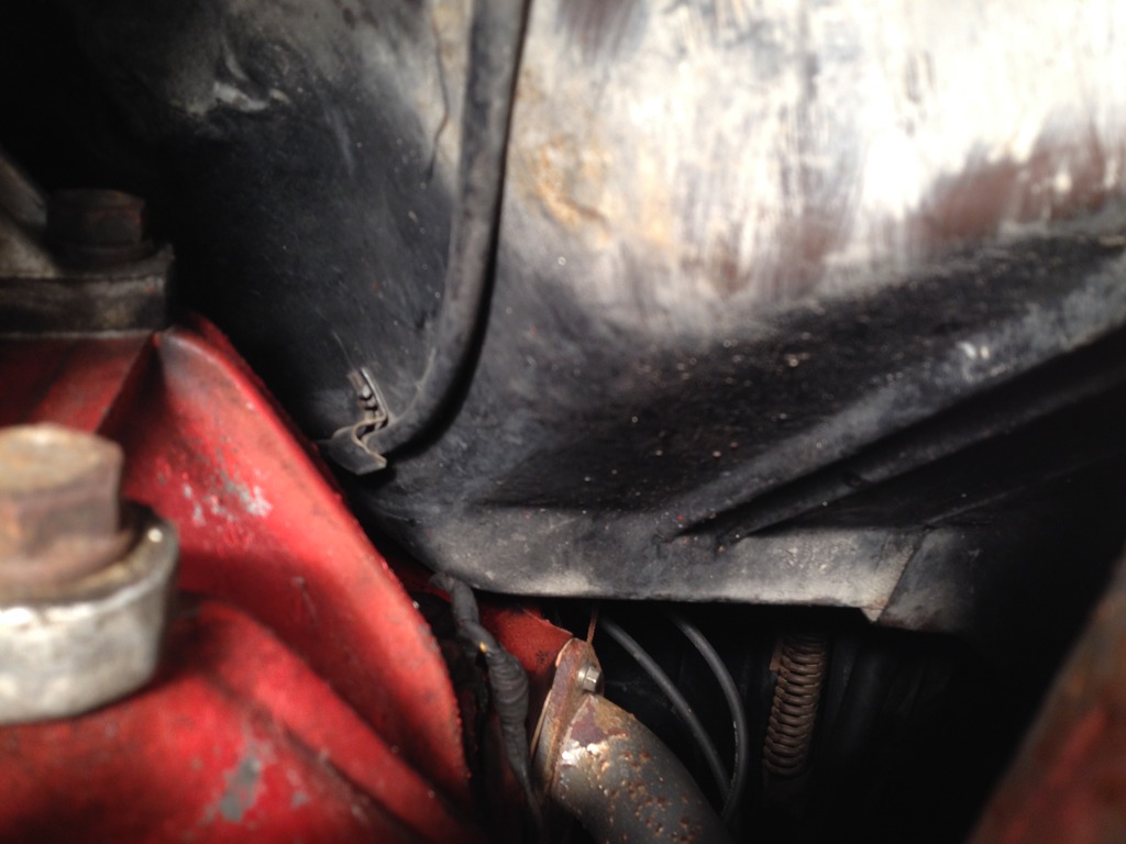

the clip on the floor tunnel area this is the clamp & screw removed looks to be original to the car it is a very early car has anyone seen this style before

Rich, heres my thoughts. That attaching bolt (which is brake/fuel line clip length) has sheet metal threads. That was not used on First Gen F Bodies. They all used 5/16-18 thread bolts.
And those cables were all held in by the butterfly clips (like the ones you sold not to long ago). My guess is it was added later. I'll be interested to hear others thoughts.

here is the floor looks to be original to the car

These are the original speedo tunnel clips.

I haven't seen any original cars without the butterfly clip type. as shown in the last two posts.

Mine is a late car but still used two of the same familiar clips on the upper and lower pinch locations for the speedo cable. I cannot say I have ever seen a fuel line clamp used in either spot, especially the lower since the screw would thread into the passenger foot compartment and would likely snag the carpet or underlay material. It was likely changed at one point.
