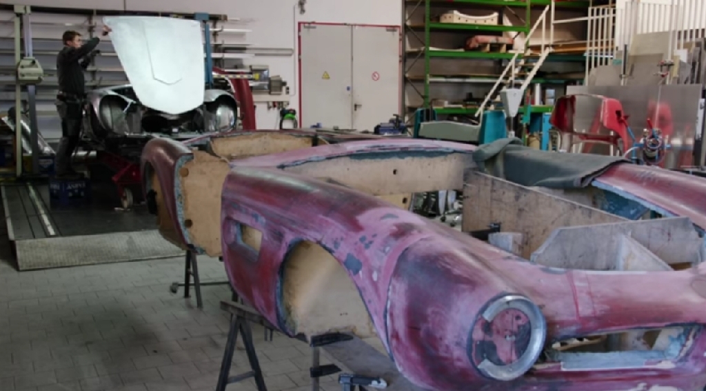

I've been doing some more research and it's getting exciting! Cannot wait to start making the buck! I talked to the Bryce and Mike at Partsnap and they may be able to scan the windshield frame and dash for me, then make the parts from a 3D printer. The windshield frame will be to form a template so I can ship that to a glass manufacturer who will use it to make the correct front windshield for me when the time comes.
Here's a picture of BMW's original assembly buck, not the hammer buck. I'm trying to get photos of that but it's a pretty closely guarded secret. Rightly so! Otherwise you'd have more idiots like me trying to do what I'm doing and actually succeed!! What I see in other restorations for other cars is the nose piece being carved from a block of solid wood, usually oak, so the curves can be hammered out directly on that. Man... good thing I was an art major before deciding to become a pilot. I knew"d that edjumacation thing would be useful one day!

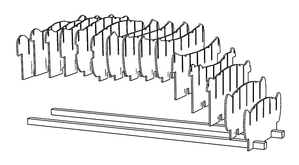

Thanks men! Yesterday was a pivotal day in Super Dave's quest for his "Ultimate Driving Machine". I picked up the 507 body buck which was exactly when they said they'd have it done. Woohoo! Mike and Bryce nailed this thing. They even made instructions for me as well. Excellent work all around. They are now going to scan the windshield frame and start making one of those for me as well so I can get a windshield made up. Just amazing this 3D scanning stuff!!
Here's a few pages of the instructions showing exactly how things are going together. Each of the stations are numbered by a small drilled hole. I've already decided that the tail panel and nose will be sculpted from wood for metal forming, which is how the original was made.
