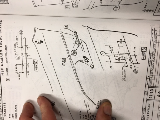

NOS fenders were installed on my car back in the late 70's so they have no holes for the Camaro emblem. I've done some searching on this topic and found a lot of horror stories about crooked emblems, AIM inaccuracies, difference between original and repo emblems. What say the experts....what is the best way to locate the holes to avoid a glaring error? Should I source some NOS emblems or are the repos ok? AIM instructions give no reference to the location of the 5 & 15 reference lines that the holes are based on.

The reference stations in the AIM are based on a datum which (as far as I can deduce) is the firewall, however that doesn't make accurately measuring the part relative to it any easier.
I have a pair of GM take-off fenders in storage, I will see if I can get good measurements of the emblem hole placement. That said, emblem stud positions may not be consistent across all versions.......
What I would do is place a sheet of paper over a block of polystyrene (or similar); carefully push the emblem down onto the paper, forcing the mounting studs through into the polystyrene behind, leaving corresponding holes in the paper. Then trace the outline of the emblem onto the paper, remove emblem and cut out the paper outline. Now you have a template to position to your satisfaction on the fender, and mark through the emblem stud holes to know where to drill.

One time I laid out the dimensions from the AIM on a piece of paper. I had NOS emblems, but if I followed holes per the AIM, on one side the emblem would angle down, and on the other, it woud angle up. I ended updoing what was suggested above, but I used cereal box cardboard. I used the hole on the "C" as a reference, and then used the cardboard template to mark the other holes. I drilled them undersized, and then filed them as needed with a jewelers file.repeated for the other side.For the Yenko badge, I just faked it, since I'm sure that's what Lynn Yenko did.
