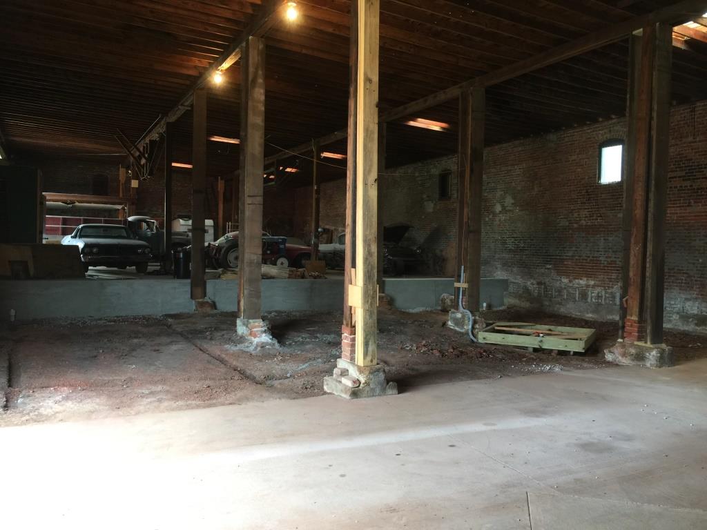

You can see from this shot that when the PO had the upper floor poured, they trucked in loads of sand for a base. The “solution” to keeping the sand in place was to place a lot of boards between the upper floor and the old wooden floor. MUCH of the sand had migrated out, going down under the wood floor.
We needed a retaining wall if I wanted a concrete floor on that lower level. Also, those two brick supports under the two wooden support posts were crumbling. If you look closely, you can see that we used some of the old floor joists to shore up the tilted wooden posts. The floor joists were probably overkill for this, but they were free. They are about 2 to 2.5 times as dense and heavy as modern wood, and there are no knots.
Look at the pic below. The floor joists are the darker wood. They are dead plumb. You can see how tilted the old posts are. Fortunately, the concrete pilasters at the base of each pillar (original to the building) are large enough to accommodate the extra wood.
In the second pic, I have removed the crumbling brick bases that went between the pillar and the wooden posts. I built temporary supports for that part of the building during the process. I sawed off the bottom of each post. I did not take pics, but I build new supports out of 4 inch steel posts (1/4 inch thick walls) welded to steel plates on each end. When we poured the retaining wall, we encased all the steel in concrete.

We built a frame to hold a concrete retaining wall using ¾ inch plywood and a bunch of 2x4 stiff backs. After hand tamping a ton of 1 inch gravel in the bottom, I lined it with a boat load of 5/8 rebar. You can see some of the framework below, but I did not get a pic of the completed form. I ran a string line across and made certain it was dead level before forming. I had 2 x 4 and 2 x 6 struts running to 2 x 4 stakes. There was a strut every 16 inches.
We rented a pumper and pumped in 9.5 yards of concrete. The wall is 45 feet long, 18 inches thick, and about 24 inches high. If you do the math, you will see that doesn’t even come close to requiring 9.5 yards. Where did all the extra concrete go? We pumped it under the existing upper slab.
This job went really fast. Gotta love the pumper. Beat the hell out of wheeling it in.
That wall will be the base for a non load bearing wall between the upper and lower levels. Even though “J” bolts were not required for an interior non load bearing wall, I put a bunch in there. Upper level is just for storage. That way, I only need to heat the lower level. Getting that wall in was a real turning point for me. I was finally believing we could get this done.
I had one small area that bowed out maybe a half inch. No one notices but me.
