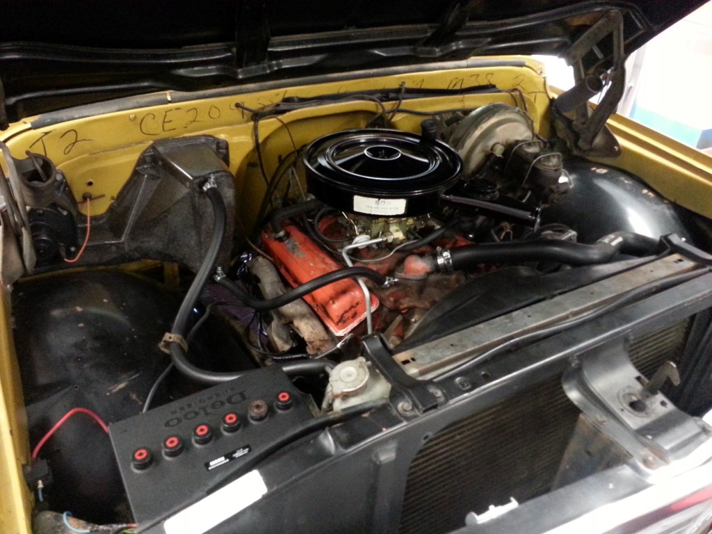

I'm a fan of just greasing and preserving what emerges under the grime. I got these results on a '71 Chevy pickup with a degreaser from Meguiar's, and combination of a pressure washer and just city pressure from a hose.

Looks great! That is the look I am aiming for.
