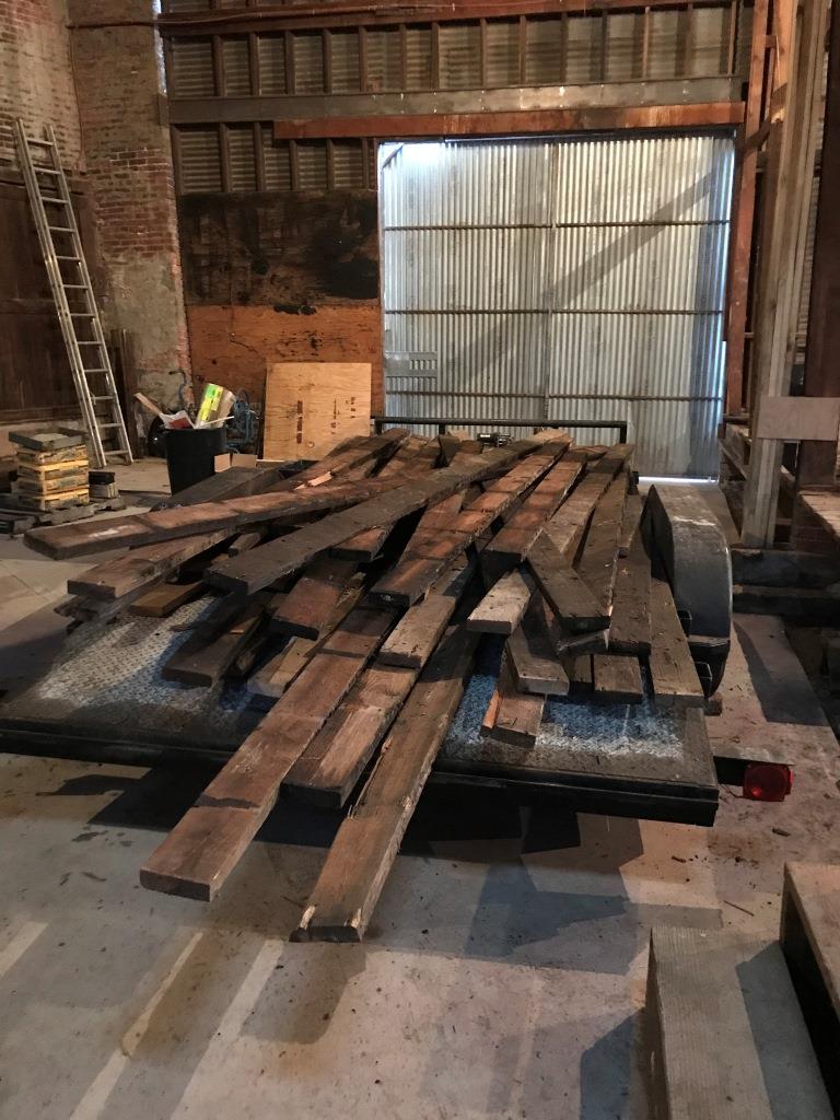

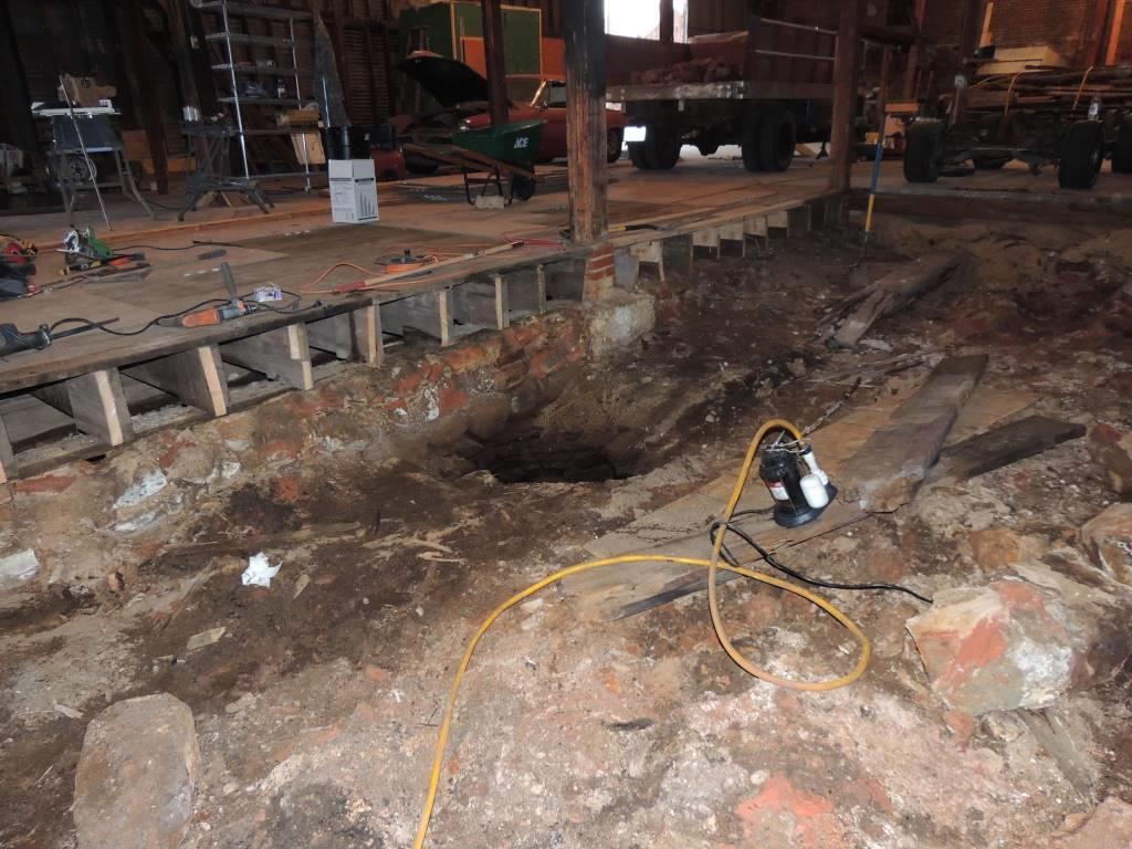

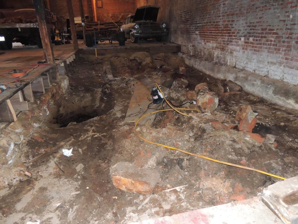

You can see from the first picture that we removed about 1/3 of the wood flooring. I took no steps to salvage any of the flooring planks. The nails were really long, hard, and partially rusty from the moist environment. So, I just sawed down the joist lines creating 16 inch boards out of that 100 year old 2 x 6 douglas fir flooring which had no knots. I felt bad throwing it all away, but pulling nails one at a time was just too time consuming. We removed that first third of flooring and the underlying joists in less than a day.
Originally, I was just going to remove that one third, build a wall, and leave the rest. But, when I found the well, it was too close to where I needed the wall. We decided to remove it all, and concrete the whole area, creating additional work spaces.
I have some great friends here in Guthrie that REALLY wanted the flooring. They are restoring an old barn. You cannot find wood like this anywhere at any price. No knots, very heavy, with as many as 40 rings to an inch. I told them I had a couple of young bucks who work cheap on Sundays, and my friends agree to pay them to pull it out, one nail at a time. Took them three sundays to get it all. You can see the progress after one Sunday. Those 2 x 12 joists are still in place in the middle third section. Set my progress back three weeks, but I was glad to see the wood get repurposed.
For some reason, when I transfer photos from my phone to the computer, they end up flipped 90 degrees. Even when I flip and save they still come out wrong, so I apologize if you have to lean your head hard to the left to see the pics.
