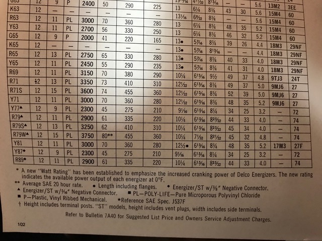

Delco Dimensional Group Sizes: The Y-77 and Y-87 were Group 72 where as the Y-79 and Y-89 were Group 74. See chart for all battery specs...
L.Z.
