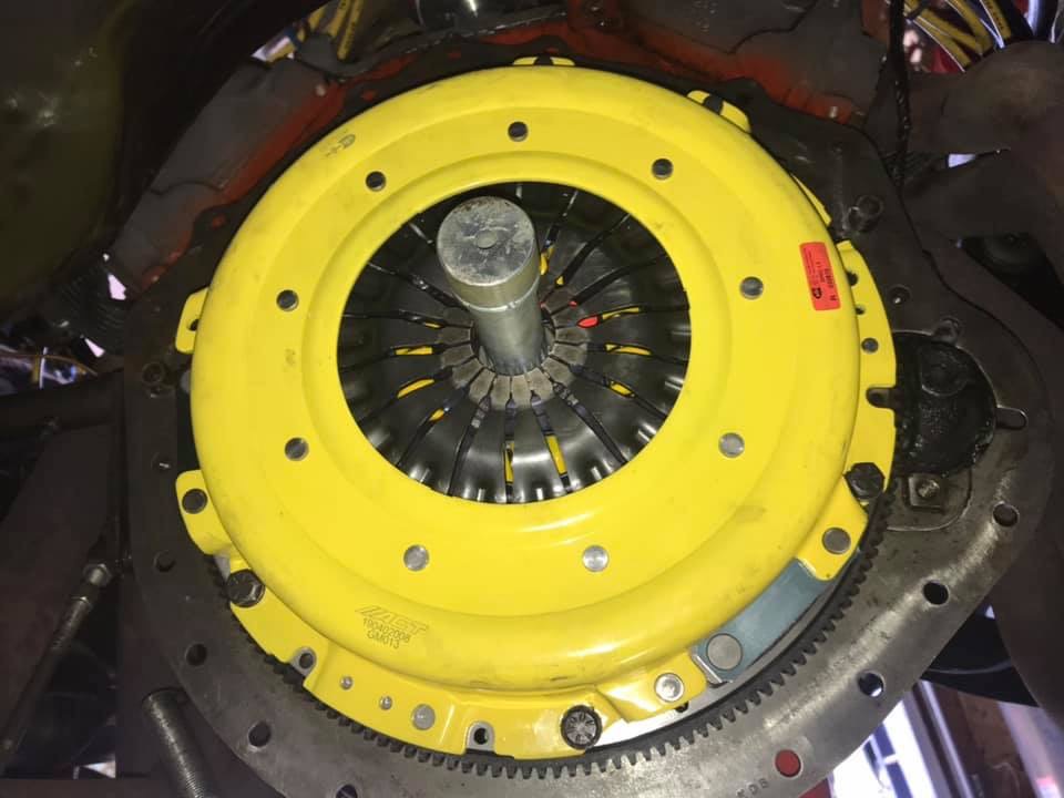

If you pushed the clutch pedal when the trans was not engaged into the pilot bushing that the disc is likely no longer aligned properly. I’m sorry to hear it is fighting with you.

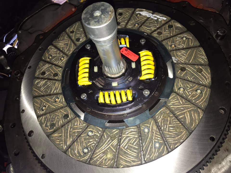

Ryan.....like I text you this morning, I had the exact issues you you’re having. I had my trans in and out 4-5 times this year. I had the plastic alignment tool and tried having my wife push the clutch in, I lifted up on the tool while tightening up the pressure plate.....nothing worked, other than bolting it up with a ratchet and then the disc will move in to place.
I purchased this alignment tool from Crash at MCACN last year and what a difference that made.....the trans slides right in to place with no issues!
In other words, try and find an old input shaft for an alignment tool.
Kurt

Thanks Kurt I need a 27 spline shaft to use as an alignment tool.
I found that my pilot bushing had come out and was sitting on an angle which was stopping the trans install.
I need to fit a new one and use a circlip this time.
Oooof.

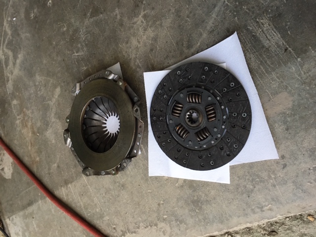

A few pictures.
I am pretty disappointed to see the wear on the clutch fork.... not sure how this occurred? Adjustment? Soft part?

Tenacity wins every time!!
I had a new pilot bushing made at 1.383” OD and added a circlip back to the crank groove. Then I reinstalled the clutch, PP, Bell, fork, and....... the transmission!!!!!
Reminder: Add oil.
I pushed in the clutch and there is no binding, I was concerned as I had to draw it in due to my poor alignment tool.
Reminder: buy used 27 Spline input shaft.

PS: this clutch fork has wear every point of contact and all were greased and it has a whopping 500 miles :-(
