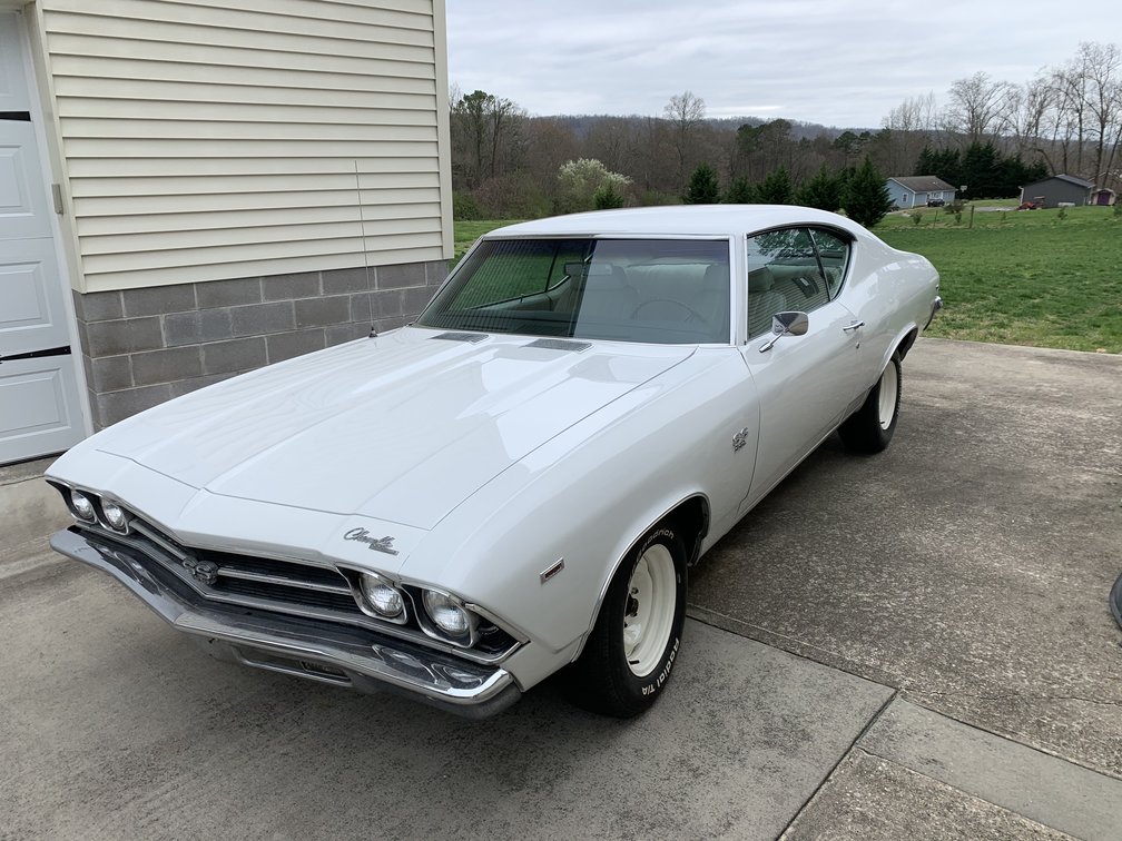

Well I bought a white on white 1969 SS396 Chevelle. I did not go see the car, just looked at pictures, so the car is not all I hoped/thought it was. I have been looking and checking the car over, and if anyone has any info, or knows the car, I would like to find out all I can. Car has papers and is a factory L-78 car, sold through Scuncio Chevrolet.
I know the car went through Barrett-Jackson last Oct. with the black stripes down the sides, but car does not have the stripes now. Checking showed new quarters and a new trunk floor. Also looks like front end may have been off for work. New paint job explains where the stripes went.
Salesman told me the engine was not original and was just a big block of some sort. Well, he couldn’t have been more wrong. Engine is a date code correct L-78 from a Camaro that was also built with a Turbo-400. Engine and rear end were built 1 day apart.
Turbo-400 is from a 1970 oval port hydraulic cam engine, but it shifts good.
But everything is sort of a mess.
There is rust, with some pin holes, probably get bigger when the work starts, around where the trunk seal goes. Lower portion mainly.
Interior shows signs of mold, like the car set for a period. Needs replaced.
Under the hood needs plenty. Spark plugs were wrong for the engine, plug wires a mess, PCV hose routed wrong, needs new wiring harnesses, radiator cap wrong, battery box rusted, etc. Wrong carb, inner fender liners cut for headers.......
Lots to do.....but if anyone knows much about the car I would like to hear from you. Thanks
