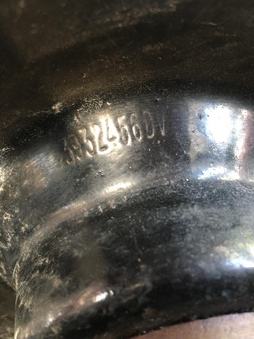

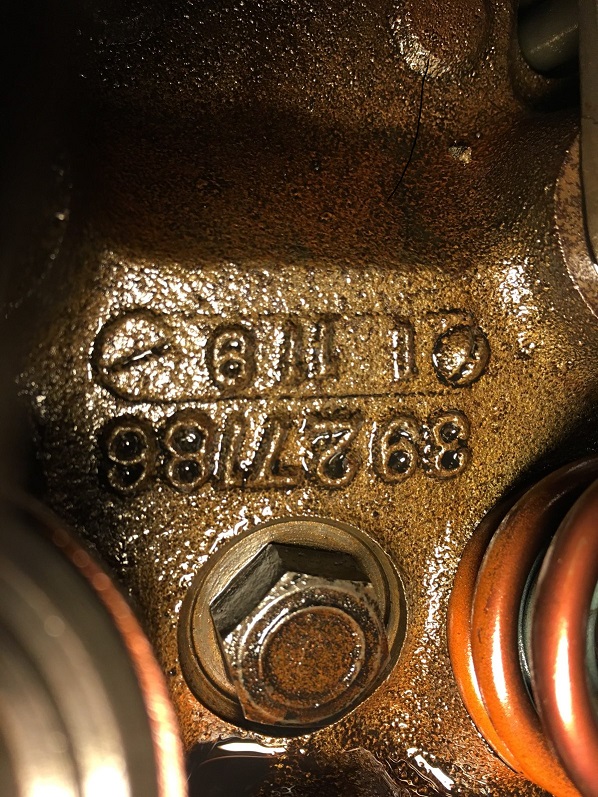

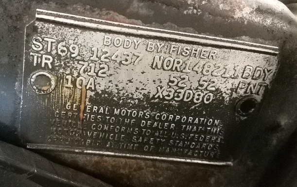

Looking to purchase this 1969 Z/28 … Would like some help with the Pad stampings and the Cowl tag please. Do they look correct and original? ANY help would be appreciated

The tag is perfect... NO PROBLEMS
I would not want to make the call on the engine stamp because the BROACH PAD NEEDS TO BE CLEANED WITH lacquer thinner before a LEGITIMATE determination can be made.

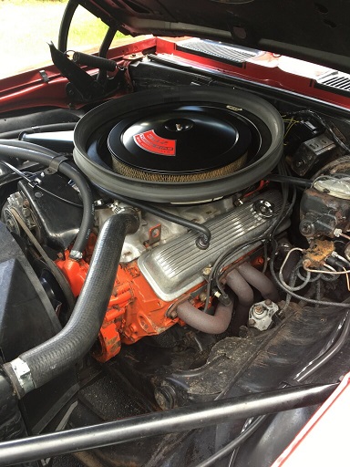

Am I seeing things or is there a crack in the cylinder head and looks close to the push rod. Not sure if it's just the picture, Or I'm just seeing things.
Old 07-27-2019, 12:49 PM
BARRY BARRY is offline
Join Date: May 2002
Location: ACTON ONT CANADA
Posts: 1,331
Thanks: 8
Thanked 73 Times in 41 Posts
Default crack
yes sure looks like a crack

Yes it does look like a crack ….. This car runs amazing too.

Looks like a hair to me.
Jason
X2...
