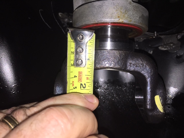

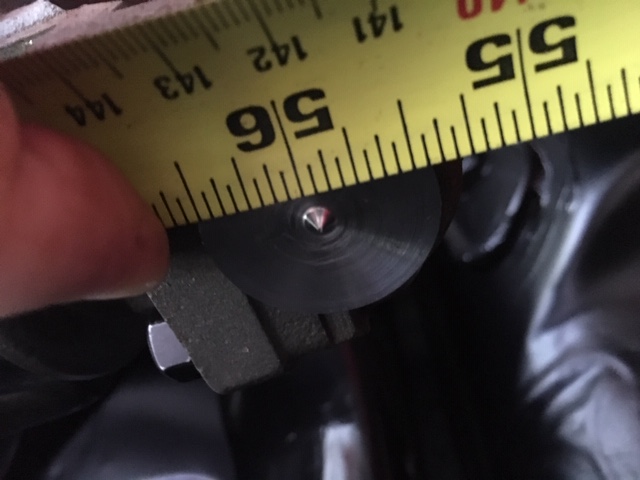

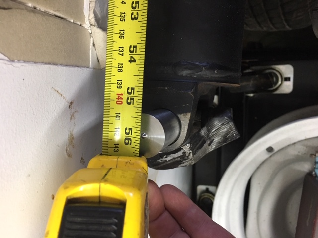

Got my driveshaft back tonight shortened by one inch.
It is perfect now as I could just install it at full droop and easily (relative term as this DS is a brute) install with rear suspension up.
This went so well I proceeded to start fitting my driveshaft loop..... moved the exhaust clamps on the X pipe.... that helped.... and I have a plan to bend the flat bottom piece up slightly and tilt the circle more to the same angle as the DS... I need a little more room at the top of the circle.... (I would say progressive progressioning..... close to progress)
