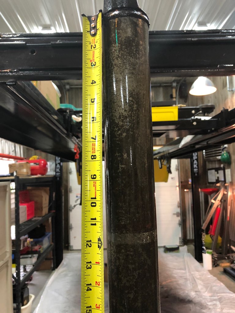

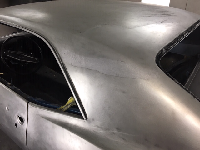

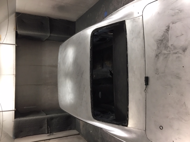

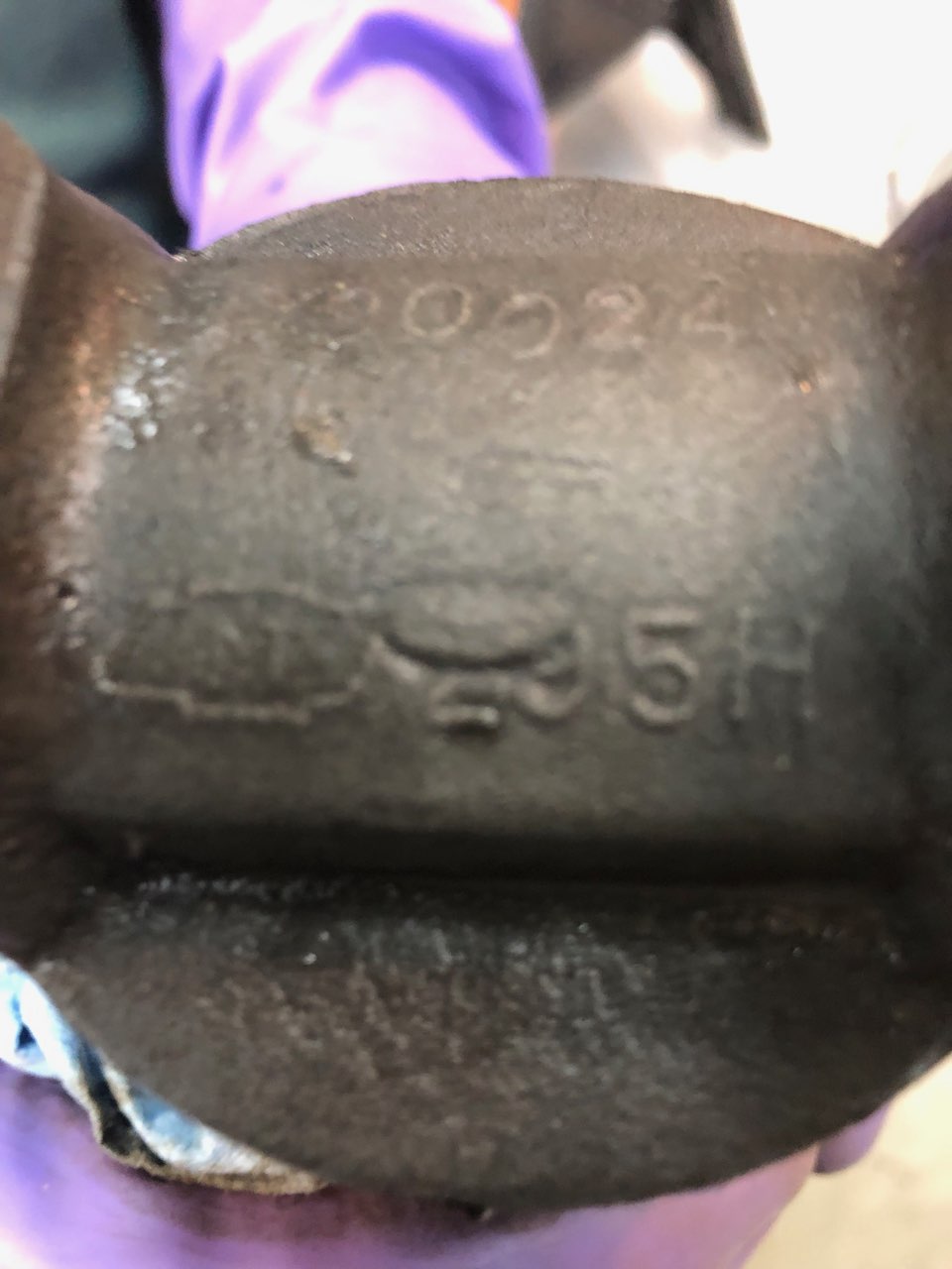

Another update on my progress......sunk my driveshaft in some evaporust and found the original painted stripes. I have no idea if this shaft is original to my car and would assume it is not due to the drivetrain swap over the years, but it's an original GM shaft. Also included some shots of the body stripped down. Very pleased with the lack of "surprises". Original panels are very nice and straight with just some minor work having been performed on the rear quarters back in the late '70's.

Talk about your clean virgin sheet metal! Nice! Looks great Jim. Do you ever sleep?

Looks great, nice and solid!

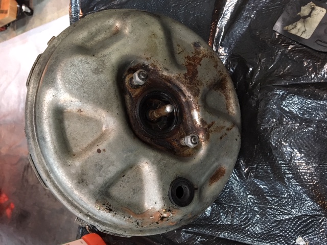

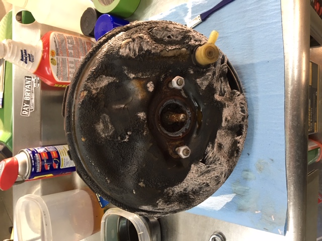

Worked on my original 9204 brake booster this week. Goal was to get it ready to ship out for re-plating. Of course it had a large amount of the gloss black paint on it so I went to town on it with some citrus stripper. It took 3 or 4 cycles of stripper and scraping with a plastic putty knife but it all came off exposing the original plating. Included a pic of the pedal connector and RBW pin as it also looks to be the original unit.

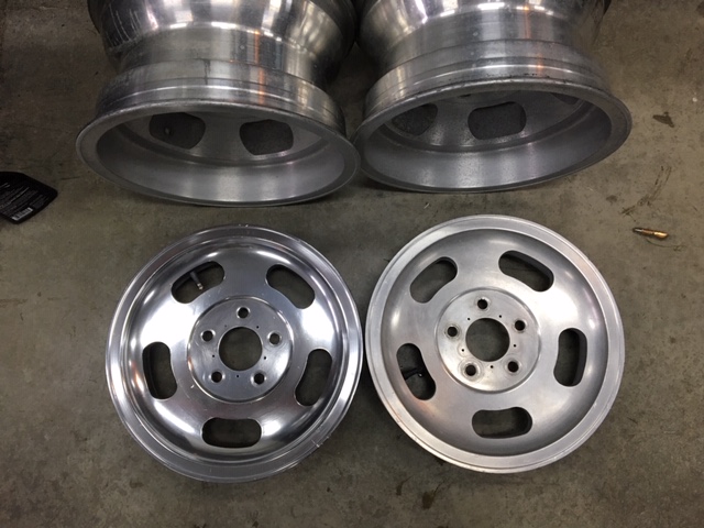

Spent some time today working on my 3.5" Fenton Gyros that will end up on the car. They're in pretty good shape with just a couple of nicks on wheel. I have more polishing to do, but am pleased with how it's coming out
