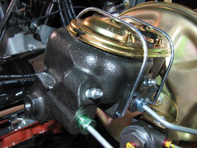

Originally Posted by SS427 View Post
My experience has been that they sometimes but not always put a flash coat of black on them. They were then machined on the front where the code was stamped as well as the two flat surfaces where the outlet lines were attached. I restored ours with a light flash coat of black and then machined the surfaces as can be seen in the photos. Our original hold off valve showed no signs of any paint on it so I restored it as such. I found no date stamping on either piece.
Thanks for the reply. It appeared in the photo to be natural finish.
  #465
Old 03-11-2019, 04:48 PM
Posts: 10,375
Thanks: 3,274
Thanked 4,812 Times in 1,182 Posts
It does look natural. I tried some different lighting and you can see a flash coat of black. I rarely ever see them fully covered in black (though they did) so I chose to just flash coat this one to give it a black tint so there was not as much contrast between it and the natural hold off valve.
